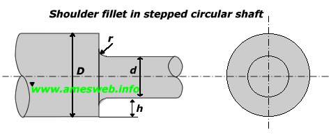

Hello all,
I was wondering, for modifying the sharp edges of a shaft, which one of the cases attached is better? Why? My guess would be the one with the radius since there are more materials remaining than the other but there should be a reason for the other case since that is also frequently done.

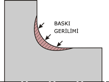

I was not able to find a better representation for the second case, now there is a better one attached.
Phinds, the shape is as described in the standard, the drawing attached belongs to it. My guess is the same as you, but there is probably a reason for it.

phinds said:
I wonder if the second one is to create a slight indentation to better seat/retain an O-ring. Just a thought.
Right sort of thinking . The undercut is to :
(a) Allow the flat and cylindrical surfaces to be ground true easily
(b) Allow assembly of the component into another component which has a true bore and face without problematic contact in the corner zone . Unwanted contact here prevents proper alignment and seating down and can be cause of fretting and other difficulties .
(2) The undercut does of itself cause a stress concentration but in suitable applications there is an overall benefit in the undercut being there .
(3) Better practice where possible is to have a normal fillet radius and chamfer the bore of the mating component .
Likes billy_joule and George Zucas
Undercuts can sometimes reduce stress concentration . An example of this is a shaft with a section of splines cut on the end . Undercutting the splines at the point where they meet the plain section of shaft reduces stress concentration at the spline roots .
Likes George Zucas
That was my thought as well. And if there is no such component, might as well go with the simple radius.
Likes George Zucas
Stress relief at a sharp corner can be accomplished by either adding material, or removing material, as seen in both of your pictures.
From what I remember,
From the first picture, an adequate fillet radius may leave not as much flat surface area for stress flow between mating parts, and there would be concentration of stress where the parts meet. An undercut can provide a larger fillet radius with a greater flat mating surface, and thus less stress concentration at both the corner and where the parts meet.
Threaded connections can have an undercut, with no loss in strength as long as the undercut is not below the thread root.
Gear teeth can have an undercut at the root, thus lowering stress concentration there also.
Type of material - a ductile material can experience some plastic flow, and so can get by with a smaller radius at a corner. A brittle cannot.
Internal properties of the material itself, such as Inclusions, can be instigators of internal cracks occurring before that at a fillet. Fillet radius and type may not be all that critical.
To stop a noticed crack from advancing from a corner of say a flat plate, one can remove ( surprising ! ) material, by drilling a hole at the base of the crack. The new larger radius of the hole becomes a stress reliever.
Likes George Zucas

The slightly deeper cut of notch1 has a wider surface area with minimum shaft diameter, so stress reduction should be improved over the simple radius1. I think the notch1 example would be easier to “shot peen” than radius1.
