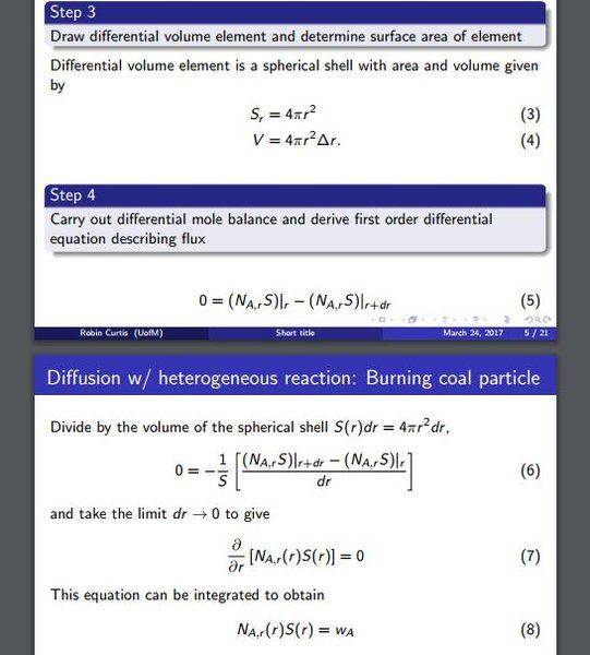

Here we divide the mole balance by the volume ##4*\pi## ##*## r2##*##dr and take lim as dr->0(standard procedure)
1) How exactly he makes the transition from equation from 6 to 7?

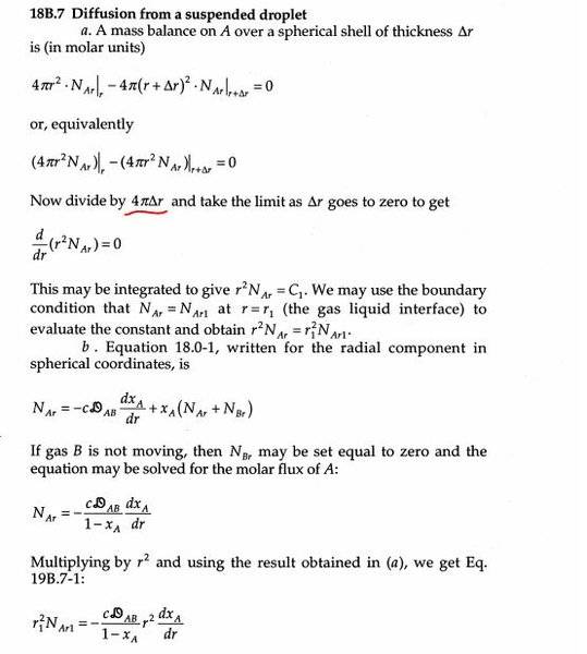

2)Why does he divide here by ##4*\pi## ##*Δr##? and not by ##4*\pi## ##*## r2##*##dr ??
Thank you very much in advance.
Because the r^2 is inside the parenthesis.

I don't get exactly how he got equation 7 from 6?

In the first problem he didnt subsitute S(r) with 4pi*r2, he let it just S(r), but why in second problem he put it inside the ( ) as 4pi*r2?
I don't get why he divided in 2nd example just by 4pi*Δr, because I can't see the difference in procedures, between the 2 examples.

In Eqn. 7, with ##S=4\pi r^2##, he would have:$$\frac{d(4\pi r^2)N}{dr}=0$$ Factoring out the ##4\pi## leaves: $$\frac{d(r^2N)}{dr}=0$$
