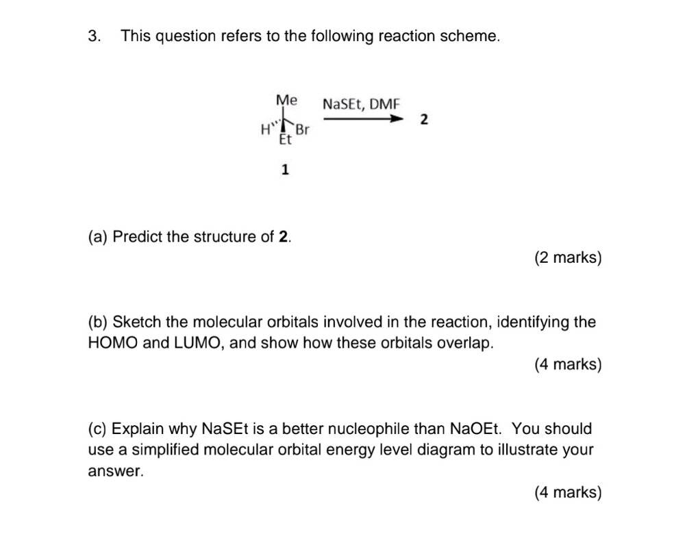

Question as attached to this thread. I'd like confirmation whether or not my solution to a) is correct. But I am mainly confused with b)
The equation can be seen in the picture. I was assuming it was an Sn2 reaction given the polar aprotic solvent and strong nucleophile.
For b), I assumed that the question asked me to draw the orbitals as shown above (as opposed to orbital diagram) because it asked me to identify the HOMO and LUMO.
I'm confused as to where SEt (-) attacks/how to draw the attack i.e. the reaction itself as both steps occur at the same time. Also I'm assuming that the orbital around S is the HOMO and the orbital around C the LUMO. Is that correct?
Thanks a lot!
Yes.
Honestly, it’s probably best to do both.
Well, you got the stereochemistry inversion correct, so where do you think the thiolate attacks?

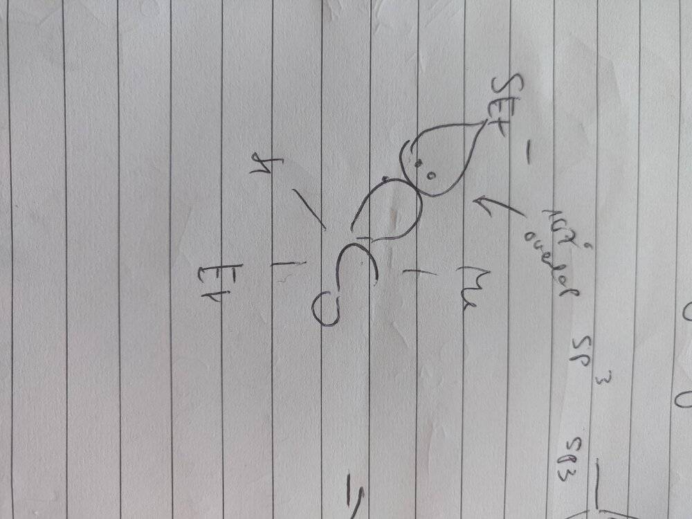

I know it's not a lot but I started working upon your prompts. In the first one is the orbital attacking the C centre with the positive charge after Br has left. Maybe it would be good to but Br- on the side too?

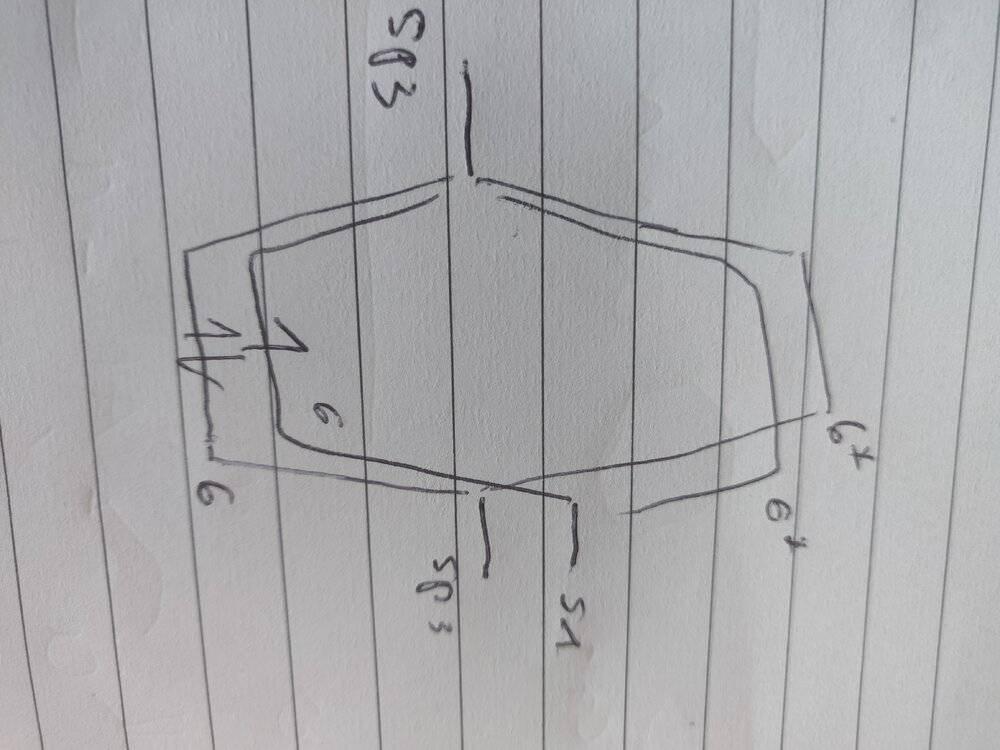

The second one is my attempt at the orbital diagram. Again, I'm not sure how this question wants me to answer this. This one shows the c centre bonding to a hydrogen and another sp3 hybridised C (again unsure how to draw in the second one as both methyl and ethyl are bonded by a sp3 hybridised C, right? Are they all of equal energy?), The one orbital bonding with SEt is missing too as of now...

Yokoko said:
after Br has left.
It’s SN2. Should Br have left?
I agree, the question isn’t particularly clear. I’ll try to focus on the most important conceptual takeaways. Instead of focusing on the hybridization of the orbitals, it’s probably better to focus on whether the interacting orbitals are bonding, non-bonding, or antibonding. Bring those ideas into your answer and see what you can come up with.

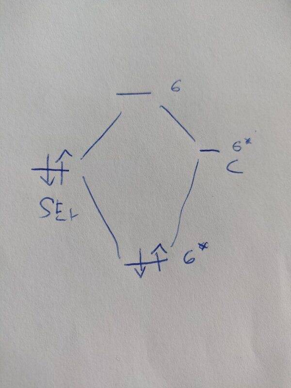

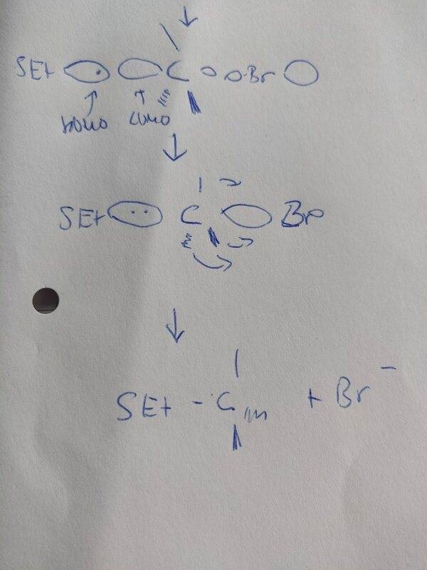

I think I've come a bit farther this time. The bonding/anti bonding hint really helped! :)
Two questions: is there only one or two e- in the orbital of SEt- ? It is a lone pair, so there would be 2 e-, correct?
And would the orbital diagram drawn enough to answer the question combined with the sketch?
Thanks again!
Getting closer. Look at the MO diagram in your second picture. Is the sigma antibonding orbital higher or lower in energy than the sigma bonding orbital?
Also, a Lewis structure should give you an idea of whether the thiolate anion has a lone pair or an unpaired electron.
Oh you are right, the C would be lower in energy, therefore under the SEt orbital.
And since the bond with sodium breaks, it seems like it only has an unpaired electron left
I meant the MOs that are formed by the interaction of the sulfur with the carbon. You have the antibonding orbital lower in energy than the bonding orbital in your picture.

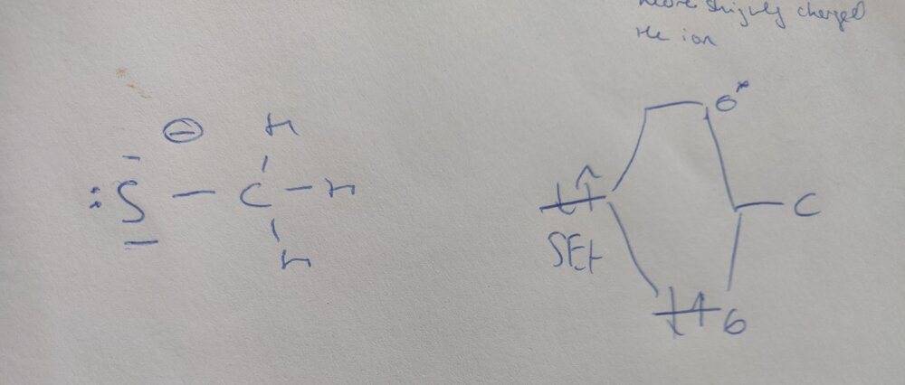

So, this should be right now. I forgot about the negative charge on the sulfur, I think that was my mistake.
Likes TeethWhitener
Better. I might have confused you before: the occupied sulfur HOMO is definitely lower in energy than the C LUMO. Otherwise it would be energetically favorable simply to transfer electrons to the lower energy empty orbital than to form a new set of MOs.
The biggest conceptual takeaway is this: the orbital that’s being created by the interaction of the thiolate with the carbon centered nucleofuge is a combination of the lone pair sulfur orbital and the C-Br antibonding orbital. The “bonding” orbital that ends up being formed by this combination has strong bonding character with the sulfur and strong antibonding character with the bromine. This is ultimately the reason that the C-Br bond breaks and the C-S bond forms.
