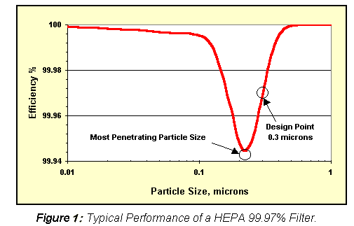

1. Normal air purifiers allow "pollutants" to multiply and be released back into the air.
Like the reviewer says, it's theoretically possible, but only if it's wet and with the fan on it isn't releasing anything back into the air. It's really a nothing claim.
2. "Many harmful pollutants such as VOCs are smaller than 0.3 microns. HEPA filters can't remove them."
So they smoosh together several claims to make the bulk claim true while giving the false impression about HEPAs and particle sizes. The true part is that yes, HEPAs can't trap VOCs. But you really shouldn't have high concentrations of VOCs in your house to begin with.
It's also worth noting that the allergy study they did doesn't compare their device against other air purifiers. The reason is probably because it doesn't perform better than other air purifiers.

It depends a lot on the age and quality of the building and the weather, but that's in the ballpark. But it is indeed true that houses being too "tight" can be a problem -- commercial buildings are basically required to have forced ventilation though.
FYI, my experience is with pharma; not much with hospitals. Some similarities for the purpose of this discussion though.
The point is: the air is refreshed more or less constantly to achieve this goal.
To be honest, I'm not quite sure what you're getting at with this post, but I can work with it: because you always have dirt/dust/pollen/whatever coming into your house and you and your pets are always shedding particles at a disturbingly high rate, the single most important factor in filtration effectiveness is airflow.
For example, if a HEPA filter processes a volume of air with a million particles at 99.97% efficiency, it removes 999,700 particles from the air. But a 90% filter would remove 900,000. And if you double the airflow for the lower efficiency filter, it removes 1.8 million particles in the same time. That's why clean rooms have very high air change rates.
Likes Dragrath
