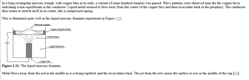

It is mentioned in the book "Ampere-Neumann Electrodynamics of Metals", Peter Graneau, that Carl Hering in 1923 operated furnaces by passing high current through the molten metal pool. He observed molten metal flow due to the currents. How is the conductor motion explained?

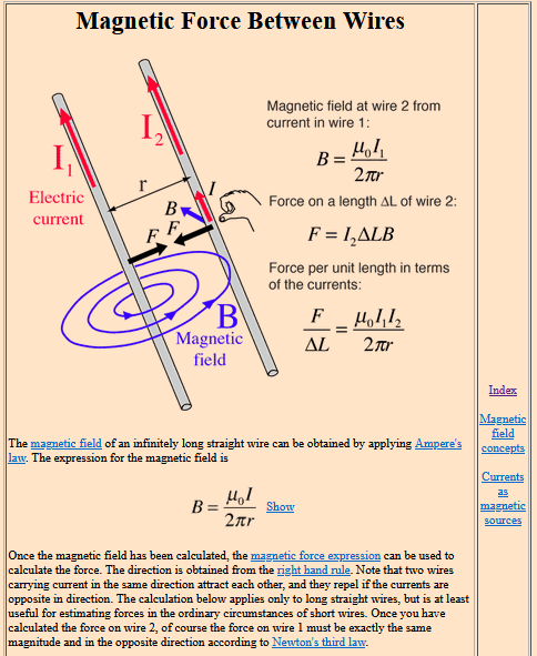

Since you haven't received any replies yet, I can ask if you are familiar with the basic equations for the forces between two parallel wires carrying equal currents. At a basic level, this would be one of the effects driving molten metal flows in the pool. There are several other secondary effects that would cause non-uniform flows as well...
http://hyperphysics.phy-astr.gsu.edu/hbase/magnetic/wirfor.html

I am not sure if the Pinch effect would cause molten metal flow. In Graneaus' experiment with a narrow trench of mercury, no visible pinch was observed - a pinch effect should cause a depression at the center of the mercury column.

Furthermore, the pinch effect is a transverse force. Flow of metal requires a force in line with the flow of metal.

All these molten metal flow experiments are independent of direction of current. It works the same with AC currents. A typical example described in the above book is the Graneau's mercury fountain experiment.

I've also searched on Graneau's mercury fountain experiment as you mentioned; is this what you are referring to?
https://dflund.se/~snorkelf/Longitudinal/node3.html
