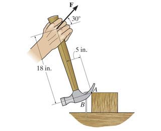

In order to pull out the nail at B, the force F exerted on the handle of the hammer must produce a clockwise moment of 590 lb⋅in about point A.(Figure 1)
Determine the required magnitude of force F.
M=590lb*in
-590= -Fcos(30)(18)-Fsin(30)(5)
I'm not sure how to deal with F. I know it's simple if given the force to determine the moment but I'm a bit stumped trying to go the other way.

How would you solve 3=x+2x?
So, F=72.9431?
Robb said:
So, F=72.9431?
Not what I get. Please post your working.
Let ##X## be the point where the force is applied to the handle.
The angle you need to use is not 30 degrees but the angle ##\alpha## between the force vector and the perpendicular to the line segment ##\overline{XA}##. You can calculate that angle using geometry, from the information given.
The Torque (moment) will be the force multiplied by ##\cos\alpha## and the length of ##\overline{XA}##.

Sorry, -590=-F18cos(30)-5Fsin30)=32.6175
Yes.
andrewkirk said:
The angle you need to use is not 30 degrees but the angle αα\alpha between the force vector and the perpendicular to the line segment ¯¯¯¯¯¯¯¯¯XAXA¯\overline{XA}. You can calculate that angle using geometry, from the information given.
the method Robb used is valid, and quite efficient.

Dang, nothing like making a mountain out of a mole hill!
So it is. I hadn't noticed that.
