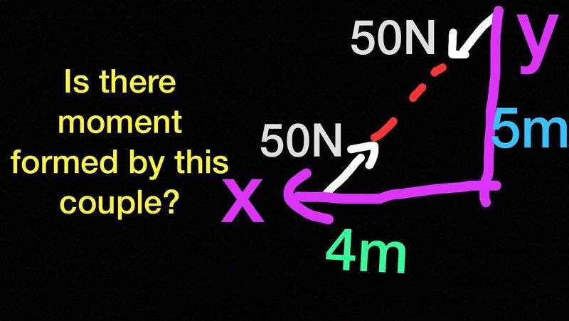

1. Homework Statement
It is a part of the question in my homework and I extract this out just for the part i m confused(in the picture above)
Moment couple=d*F
[d is the difference in point of application (=sqrt41) or the perpendicular distance of the forces(=0) ?]
As the forces on the same straight line in oppsite direction, I think they will cancel out each other...
Yet, I am not sure if there would be moment formed by the couple...
Thanks

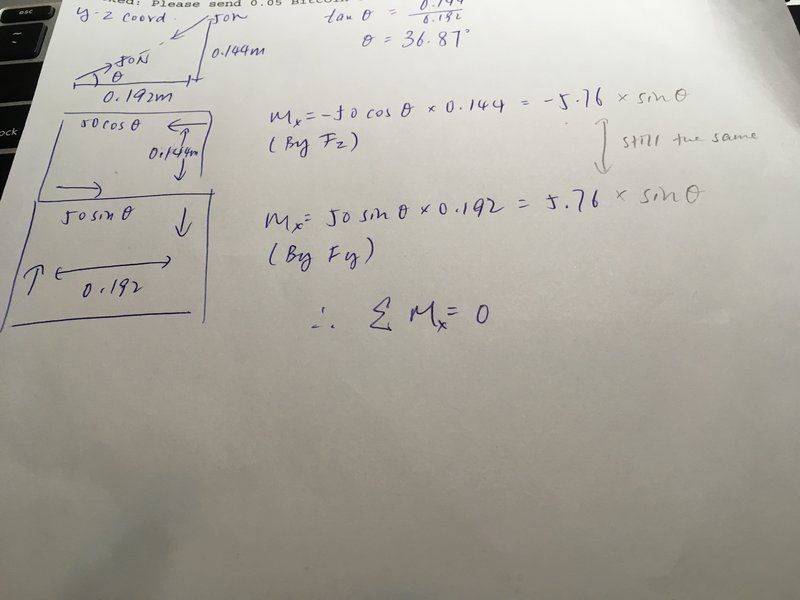

This is good intuition, but if you are unsure you should back it up with mathematics.
This is my mathematical prove
