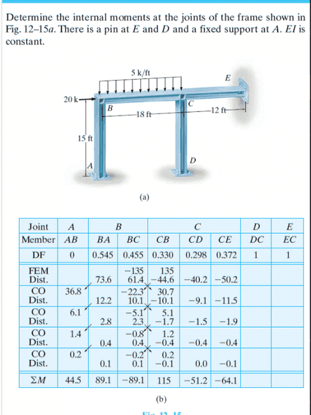

Moment distibution (stiffness factor modifications) for a frame
In summary, the homework equations connect A to D by a hinge, but at the bottom of CD, it is not restrained by A. At the top of AB, sideways movement of B is resisted by the joint at A. In the beam BC, vertical movement at B is resisted by the combination of the rigidity of BCE and constraints at D and E. C cannot move up or down because of D. B can only move left or right because of E. At the bottom of CD, sideways movement of C is not restrained by A.

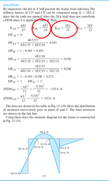

For the KAb and KCD , they are connected by the same method ... At B and C , we can see that they are connected by the same method , although i am not sure it's fixed or pinned .
I assume they are fixed at B and C , so i agree that KAB is 4EI / L for far end fixed case . So , i think KCD should be 4EI / L as well .

fonseh said:
far end fixed
Aren't the "far ends" A and D? One is fixed and one is pinned.
Likes fonseh
B and C are fixed ? How do we know that ? It's not stated in the question
No, not B and C; A and D. As I read it, the stiffness factor at one end of a beam depends on whether the far end (other end) is fixed or only pinned. That makes intuitive sense to me.
A, B and C are fixed, so for the interactions at B and C:
AB is 4 because A is fixed
BC is 4 at each end because the other end is fixed
CD is 3 because D is pinned
CE is 3 because E is pinned
Likes fonseh
Which end is fixed ? B or C ?
Both are "fixed". (I think this just means it's a rigid joint, not a hinge.)

I might have it...
The question of "far end fixed" is to do with sideways flexing at the "near end" being inhibited by the far end.
At the top of CD, sideways movement of C is not resisted by the joint D since that is a hinge.
In the beam BC, vertical movement at B is resisted by the combination of the rigidity of BCE and constraints at D and E. C cannot move up or down because of D. The rigidity of BCE then inhibits vertical movement at B.
Similarly, vertical movement at C is resisted by the combination of the rigidity of BCE and constraints at AB and E. B cannot move up or down because of A.
