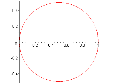

The hoop has radius R.
I used the same way to plot the axis for the hoop:
##l^2 = r^2= 4R^2cos\theta##
since: ##r=2Rcos\theta##
[tex]2\rho \int_{0}^{\frac{\pi}{2}} r^2 r d\theta[/tex]
[tex]
2\rho \int_{0}^{\frac{\pi}{2}} 8R^3 cos^3\theta d\theta[/tex]
answer is [tex]\frac{32}{3}R^3\rho[/tex] , and its wrong
using the same method to find mass is also wrong, which suggest a fundamental mistake in my solution but I don't know what it is.
[tex]2\rho \int_{0}^{\frac{\pi}{2}} r d\theta[/tex]
[tex]
2\rho \int_{0}^{\frac{\pi}{2}} 2R cos\theta d\theta[/tex]
that's equal [tex]4\pi r[/tex] which is wrong
what is wrong with my solution?, it was really bizarre when I found that the mass itself using the limits I found actually gives a wrong answer.
What did I miss?

The question is general, they just want a general solution. Question: "What is the moment of inertia about a tangent of a circle of radius R, density ρ"
I used the same way to plot the axis for the hoop "So that y-axis is the tangent":
##l^2 = x^2= 4R^2cos^4\theta##
since: ##r=2Rcos\theta## & ##cos\theta = \frac{x}{r} = \frac{r}{2R}##
[tex]2\rho \int_{0}^{\frac{\pi}{2}} x^2 r d\theta[/tex]
[tex]2\rho \int_{0}^{\frac{\pi}{2}} 8R^3 cos^5\theta d\theta[/tex]
answer is [tex]\frac{128}{15}R^3\rho[/tex] , and its wrong
[tex]2\rho \int_{0}^{\frac{\pi}{2}} 2R cos\theta d\theta[/tex]
that's equal [tex]4\pi r \rho[/tex] which is wrong
What did I miss?

We have a hoop of radius R, the question is to find the moment of inertia on a tangent to the hoop "any tangent will have the same moment of inertia".
The plot was just to show that I didn't draw the center of the "hoop" at the origin, instead I draw it as the plot show "center (R,0)", so that I can find the moment of inertia about y-axis, since now y-axis is the tangent of the hoop.

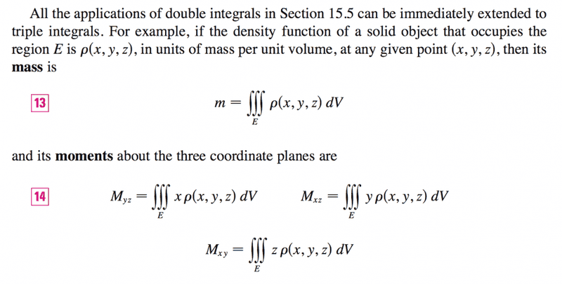

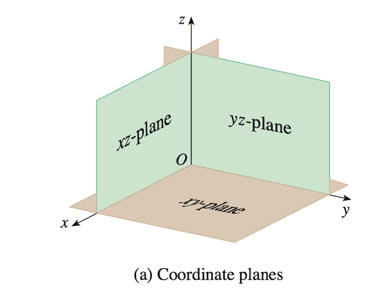

EDIT: I found a textbook reference that should make what I'm saying more reasonable to you:
Zondrina said:
Yes, the wire is a solid object with density, which has been looped. Let's not be took picky about the imaginative process since thickness isn't relevant anyway. I like imagining a fat loop, perhaps you enjoy a skinny wire.
Wait what? We take moments of inertia about co-ordinate planes. Perhaps I was unclear, I should have written the moment as:
$$M_{yz} = \iiint_E x \rho(x, y, z) \space dV$$
and said the yz-plane, not the x-plane. I guess I was looking at the x in the integral. In any case, if we want to do a moment about the y-axis through the xy-plane, we would just use:
$$M_{xy} = \iiint_E z \rho(x, y, z) \space dV$$
We could have found the moment of inertia using any co-ordinate plane and gotten the same answer because of symmetry anyway.
Those are not moments of inertia. Those are first moments.a.k.a. moments of torque.
The moment of inertia is a second moment.
See this Wikipedia entry: https://en.wikipedia.org/wiki/Moment_(physics)#Elaboration
Likes Nidum

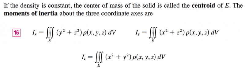

I have found the correct section of the textbook:
I was extremely tired yesterday because I had zero hours of sleep. I probably shouldn't be trying to do math without being properly rested first.
Sorry about that.
Likes ahmed markhoos

θ refers to the angle at the origin. Instead of writing ##-\frac{\pi}{2},\frac{\pi}{2}##. I just put it from 0 to ##\frac{\pi}{2}##. and multiplied the integration by 2.
That sounds good. Now, how did you get from [tex]2\rho \int_{0}^{\frac{\pi}{2}} x^2 r d\theta[/tex]
to
[tex]2\rho \int_{0}^{\frac{\pi}{2}} 8R^3 cos^5\theta d\theta[/tex]?
The first looks correct. The second does not.
If you show your working, someone can identify where you went wrong.
Hint: you have used ##r## in your first formula and ##R## in your second. Presumably the first is the radius of the circle. What is the second? Is it the same as ##r## and is it constant with respect to ##\theta##?
to
Lots of stuff wrong in this thread. The 2d formulas Zondrina is giving are irrelevant.
Also, the first equation in the quote above is not correct. Assuming ##\rho## is a linear density, the correct expression for the second moment would be$$
\int x^2\rho~ds$$where everything is expressed in terms of ##\theta##. To set it up correctly you need the polar equation of the hoop in the form ##r = f(\theta)##, which I don't see where anyone has given, and from it the correct formula for ##ds##. It is not ##rd\theta##. Start by writing the polar equation of the hoop.
[Edit, added]: I see where the OP did write the polar equation of the hoop in post #5. His error there is not using the correct ##ds##.
I agree. I hadn't noticed that, but while the formula would be right if ##\theta## were the angle at the centre of the circle and ##r## is the circle radius (because then ##ds=rd\theta##), it's not right when ##\theta## is the angle at the origin, which is what the OPer said.
It seems to me that integrating over angles at the centre of the circle is by far the easiest approach, because one gets a very simple integrand, and very little geometry is needed.
