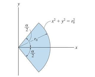

Determine the moment of inertia of the shaded area about the x-axis.

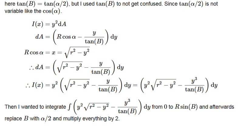

In order to determine the moment of inertia of the shaded area about the x-axis I first looked at the portion above the x-axis, integrate it with a small rectangular element and then because of the symmetry I would multiply it with 2. So:
Yet if I integrate that with those limits and then multiply it with 2 and insert B= a/2
I do not get (a-sin (a))(r^4)/8. The answer I would get if I just use ∫∫((r*sinθ)^2)rdθdr. Which is the correct answer.

Yeah you are right, I see now how the integral with sin^-1 and tan^-1 are the same. But so that whole integral 2∫(y^2√(R^2-y^2)+y^3/tan(a/2))dy with limits 0 to Rsin(a/2) will clean up to r^4/8(a-sin(a))? Because that I do not see.
Post your attempt to demonstrate this. Start by writing out the expression for the definite integral with the given limits. Then simplify. I or somebody else may help you if you get stuck. Using latex to make your formulas easy to read will greatly increase the chance of receiving help.
