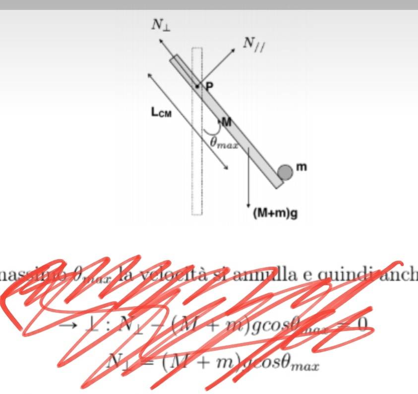

But if the system was on a vertical plane, wouldn't it represent a physical pendulum? And i know that, for physical pendulum, the force have a radial and normal component
the diagram of the forces drawn by my professor. In this case web have a rod that hits a mass in a vertical plane
Whoops! You are right! I was forgetting the rod has mass, so moment of inertia. This invalidates the string analogy. The hinge reaction normal to the rod provides the torque for angular acceleration of the rod.
Don't know if there is an easier way, but I got an answer by considering the angular acceleration of the rod and the tangential accelerations of rod and mass. I introduced unknowns for the normal forces each end of the rod and the angular acceleration of the rod.

I called the normal forces at the ends of the rod N (hinge end) and N', both clockwise about the rod's centre. I is the MoI of the rod about its centre, ##=\frac 1{12}ML^2##.
Rotations positive clockwise, angled measured from upward vertical.
##I\alpha=(N+N')\frac L2##
##M\frac L2\alpha=Mg\sin(\theta)-N+N'##
##mL\alpha=mg\sin(\theta)-N'##
Whence
##(\frac 12M+m)L\alpha=(M+m)g\sin(\theta)-N##
##2I\alpha=NL-mL^2\alpha+mgL\sin(\theta)##
##(2I+mL^2)\alpha=NL+mgL\sin(\theta)##
##(\frac 12M+m)L(NL+mgL\sin(\theta))=((M+m)g\sin(\theta)-N)(2I+mL^2)##
##N((\frac 12M+2m)L^2+2I)=g\sin(\theta)(\frac 12MmL^2+(M+m)2I)##
Substituting for I:
##N((\frac 12M+2m)L^2+\frac 16ML^2)=g\sin(\theta)(\frac 12MmL^2+(M+m)\frac 16ML^2)##
##N((3M+12m)+M)=g\sin(\theta)(3Mm+(M+m)M)##
##N(4M+12m)=g\sin(\theta)(4Mm+M^2)##
##N=\frac{M(M+4m)}{4(M+3m)}g\sin(\theta)##.
Note that this is zero if g is zero (horizontal plane, as in the question) or M is zero (light string) or the rod is vertical.
