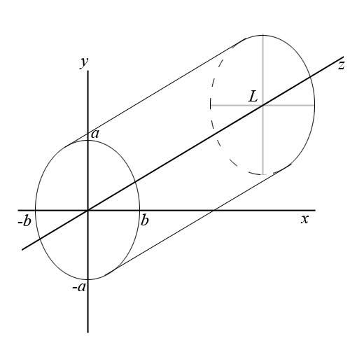

Hi,
I'm trying to work out the moment of inertia [itex]I[/itex] of an elliptical beam, about it's length-axis.
The elliptical beam has a length [itex]L[/itex] along the z-axis, a semi-major axis of length [itex]a[/itex] along the y-axis, and semi-minor axis of length [itex]b[/itex] along the x-axis:
Now, I have done some moment of inertia calculations in the past but all of them involved only the 'simple' single-integral formula:
[tex]I = \int r^2 dm[/tex]
Now however I am supposed to use the triple-integral formula:
[tex]I = \int \int \int_V r^2 \, \rho \, dV[/tex]

Then I went on to the ellips. I figured I simply need to do a convenient coordinate transformation, just like I used the transformation to cylinder coordinates for the cylinder, right?
So, I know the equation of the ellips is:
[tex]\left( \frac{x}{b} \right)^2 + \left( \frac{y}{a} \right)^2 = 1[/tex]
So I figured a good transformation would be:
[tex]u = \frac{x}{b} \text{ , } v = \frac{y}{a}[/tex]
Which would make it a circle:
[tex]u^2 + v^2 = 1[/tex]
Then, the conversion from dV = dx dy dz to dV = du dv dz is calculated with the Jacobian determinant, right? I don't know how to type this out in latex so I'll try to describe what I did.
[tex]\frac{ \partial (u, v)}{\partial (x,y)} = \text{ that determinant } = \frac{1}{a} \times \frac{1}{b} - 0 = \frac{1}{ab}[/tex]
So
[tex]\frac{ \partial (x,y)}{\partial (u,v)} = \frac{1}{1/ab} = ab[/tex]
So [tex]dV = dx \, dy \,dz = ab du \, dv \, dz[/tex]
Then:
[tex]I = \int_0^L dz \int_0^1 du \int_0^1 (u^2 + v^2) \rho \, ab \, dv[/tex]
[tex]\rho = \frac{m}{\pi a b L}[/tex]
[tex]I = \frac{m}{\pi a b L} \int_0^L dz \int_0^1 du \int_0^1 (u^2 + v^2)\, ab \, dv[/tex]
[tex]I = \frac{m}{\pi a b L} a b L \int_0^1 (u^2 + \frac{1}{3}) du = \frac{2m}{3\pi}[/tex]
And that does not make any sense to me... I am quite sure it is not independent of a and b...
What did I do wrong? Thanks!

Ok, I managed to get the correct answer now using Maple. I tried it once without using any substitutions, and it came out correct!
The integral I had maple calculate was:
[tex]I = \int_0^L dz \int_{-b}^b dx \int_{-a \sqrt{1-\frac{x^2}{b^2}}}^{a \sqrt{1-\frac{x^2}{b^2}}} (x^2 + y^2) \rho dy[/tex]
[tex]I = \rho \, L \, \frac{1}{4} \pi (ab^3 + ba^3) = \frac{m}{\pi a b L}L \pi (ab^3 + ba^3) = \frac{1}{4}m(a^2 + b^2)[/tex]
However, I am pretty sure I could not have done this by hand... So I suppose I am doing something wrong with the substitution... Can anyone see what?

I still wanted to know how to do it using the substitution I have learned, and I finally saw what I did wrong.
I wrote the r^2 as u^2 + v^2, but that's wrong ofcourse...
[tex]r^2 = x^2 + y^2 = (bu)^2 + (av)^2[/tex]
Using that in the following integral yields the correct result!
[tex]I = \rho \int_0^L dz \int_{-1}^1 du \int_{- \sqrt{1-u^2}}^{\sqrt{1-u^2}} \left( (bu)^2 + (av)^2 \right) ab \, dv = \frac{1}{4}m(a^2 + b^2)[/tex]
This is still done with maple however, I am going to try to do it by hand now, see how far I get...
Got it :D
Using the substitution x = bu, y = av, I can set up the integral until I arrive at:
[tex]I = \rho \int_0^L dz \int_{-1}^1 du \int_{- \sqrt{1-u^2}}^{\sqrt{1-u^2}} \left( (bu)^2 + (av)^2 \right) ab \, dv = \frac{m}{\pi} \int_{-1}^1 du \int_{- \sqrt{1-u^2}}^{\sqrt{1-u^2}} \left( (bu)^2 + (av)^2 \right) dv[/tex]
Then, I use another substitution to polar coordinates:
[tex]v = r \sin \theta[/tex]
[tex]u = r \cos \theta[/tex]
Which changes the integral to:
[tex]I = \frac{m}{\pi} \int_0^{2\pi} d\theta \int_0^1 \left( b^2 \cos^2 \theta + a^2 \sin^2 \theta \right) r^3 \, dr[/tex]
[tex]I = \frac{m}{4\pi} \int_0^{2\pi} \left( b^2 \cos^2 \theta + a^2 \sin^2 \theta \right)[/tex]
Both the cos^2 and sin^2 integrals evaluate to pi, so:
[tex]I = \frac{m}{4 \pi}(b^2 \pi + a^2 \pi) = \frac{1}{4}m(a^2 + b^2)[/tex]
Yay!
