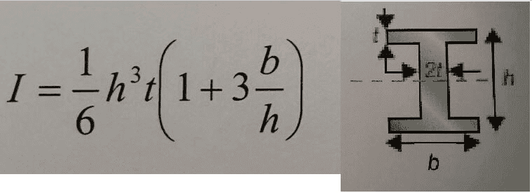

Hello, this formula was given to me in an exam to find the moment of inertia of an I beam,
https://ibb.co/jY7ZKG
jY7ZKG
jY7ZKG
However this formula seems to give a different answer to the standard bd^3/12 method, is the formula in the image wrong ?
Thanks

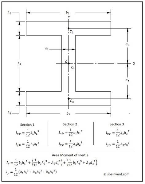

It seems to be a crude approximation of the appropriate way of doing it (see ##I_x##, from source):

I have attached an image showing my working using both formulas, and also a picture showing the I beam dimensions (web thickness is 20mm).
https://ibb.co/nMDCrw
Using Skyciv's online beam calculator returns an I value of 7.73x10^6 mm^4 , the same as i got on top line. Also this is only concerning the Ixx value and not Iyy , and I is referring to the second moment of area.
I don't understand how the second formula can return a different value and still be correct, i must be missing something :-/
Thanks

The formula in the exam is correct but it is approximate. It is obtained by taking the web and adding the flanges by the Steiner's theorem:
I = 2t*h3/12 + 2*b*t*(h/2)2
I = t*h3/6 + b*t*h2/2
I = (t*h3/6) + 3*b/h*(t*h3/6)
I = t*h3/6*(1 + 3*b/h)
The problem is that web and flanges overlap, so this formula produces higher values than the exact one.
It can be used only for thin-walled sections where 't' is much smaller than the other dimensions. Then the overlap becomes negligible.
