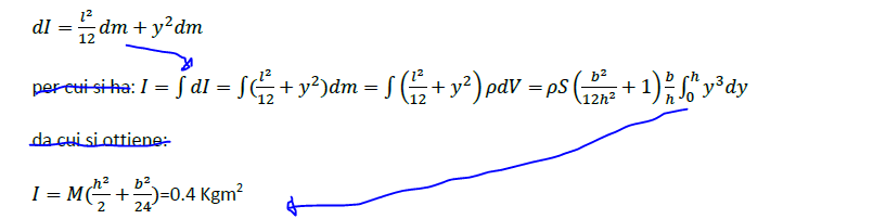

I did in this way:
## I = \int dm \rho^2 ##
Dividing the triangle in small rectangles with ##dA = dy x(y) ## where ##x(y) = 2 ctg( \alpha ) (h - y) ##
we have : ## dm = \sigma 2 ctg( \alpha ) (h - y) ##
Now i have ## \rho^2 = x^2 + (h-y)^2 ##
Now I don't know what I can do because it would be an integral in 2 variables that I don't know how to do

As has been mentioned, it's easier to impose a Cartesian frame (e.g. origin at top of triangle, ##x## axis running along the height), then the region of integration is specified by ##-\frac{x}{\tan{\alpha}} \leq y \leq \frac{x}{\tan{\alpha}}## and ##0 \leq x \leq h##, so you can write down the integral$$I_z = \int_S \rho r^2 dx dy = \int_0^h \int_{-\frac{x}{\tan{\alpha}}}^{\frac{x}{\tan{\alpha}}} \rho (x^2 + y^2) dy dx$$where ##\rho## is the area density. To evaluate this you can do the inner integral first, holding ##x## constant, and then feed the result into the outer integral.

The moment of inertia of a thin strip about its midpoint is a well known formula. That plus the parallel axis theorem gets you to the moment of inertia of a thin strip about the apex here.

I watched some videos on youtube about double integrals and i got these results
## I_z = \frac{5 \rho h^4}{12 tan( \alpha) } = \frac{5 M h^2}{12} ##
Hope it's correct
I noticed in this moment that is present the solution of this problem:
"For the calculation of the moment of inertia, can be considered the moment of inertia of the elementary rod with mass dm, thickness dy and length l = l (y) indicated in the figure, where y is the distance from the apex of the triangle . In this case, for Steiner's theorem the moment of inertia can be written as:"
Sorry if the solution is not written in english, but there was written nothing important, so I simply tried to explain what was written with arrows
