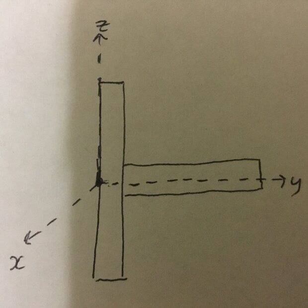

A bar of length 10cm and diameter 2cm is positioned vertically, it has another bar of length 5cm and diameter 2cm attached at a right angle to its middle. The density is 800 kg m^-3. Find the position of the centre of mass. Then find the moments of inertia about 3 perpendicular axis through its centre of mass.
Xcm = m1x1 + m2x2 / m1 + m2
I = mr^2/2 (for a bar)
Using the equation above I get Xcm = 0.022 m. I set the origin be at the left of the vertical rod parallel to its centre of mass as in the diagram. But I’m not sure if the equation is correct for 3d.
for the moments of inertia I am using
I = Icm + md^2
= (mr^2)/2 + md^2
where d is the distance from the centre of mass to the axis. Does this equation seem correct?

I don't believe so. Please elaborate on your calculations. Also, figure out how to format your mathematics using Latex so it is easily read.

The diagram shows one axis not crossing the center of mass.
Locating that center should be the first step.

Oh I see. ##x_{cm}## is not the proper label. Per the diagram they found ##y_{cm}##. I think we are assuming ##x_{cm} = 0 = z_{cm}##.

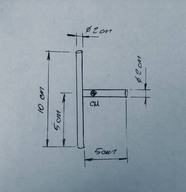

I may be wrong, but I am getting ##y=1.83~cm## as the location for CM measured from the left surface of the 10 cm vertical rod (plane x-z).

Do you mean ##18.3 \rm{cm}##? I got ## y_{cm} = 21.7 \rm{cm}## How are you assuming they are connected ( I'm assuming they are basically set next to each other and welded)?

As I understand it (again, perhaps wrongly), the biggest dimensions of the assembled “T” are 7 cm and 10 cm.
No, that's how I assumed it too. Maybe I made a computational mistake.

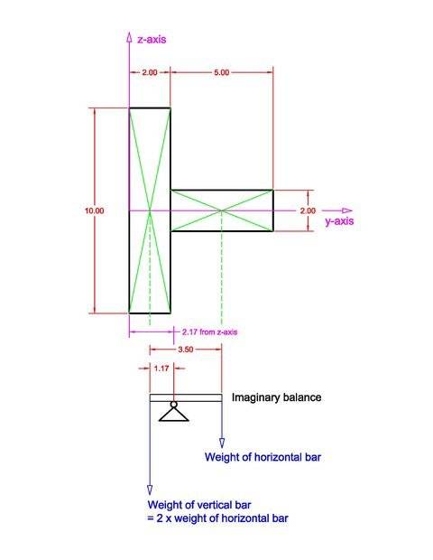

The mass of the vertical rod is two times the mass of the horizontal one.
So, ignoring the weld. Here is what I did:
$$ y_{cm} = \frac{\rho \frac{\pi D^2}{4} \cdot 10 \cdot 1 + \rho \frac{\pi D^2}{4} \cdot 5 \cdot ( 2 + 2.5) }{ \rho \frac{\pi D^2}{4} ( 10 + 5 ) } = \frac{10+5\cdot(2+2.5)}{15} \approx 2.17 \rm{cm}$$
I did make a mistake. It was ##2.17 \rm{cm}## not ##21.7 \rm{cm}##. We still get different results as you are getting ##1.83 \rm{cm}## ?

Your calculation is correct; mine was not.
Please, see attached scaled diagram (PDF format below).
Thank you very much, @erobz
