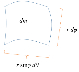

The differential mass, [itex] dm [/itex] is calculated by
[itex] dm = \rho_s (\mathrm{differential \ length})(\mathrm{differential \ width}) [/itex]
A picture might help here. The following is a picture of a small, differential patch of surface on a sphere of radius [itex] r [/itex], where [itex] \theta [/itex] represents longitude and [itex] \varphi [/itex] represents latitude (well, lattidue with 0 deg and 180 deg defining the poles).
This differential mass can be used in calculating the moment of inertia, keeping care to properly specify the distance of [itex] dm [/itex] to the axis of rotation. The integral can then be carried out integrating over [itex] \theta [/itex] and [itex] \varphi [/itex] . Only two integrals are necessary.
No integration over the radius of the sphere [itex] r [/itex] is necessary. The radius of the sphere treated as a constant. (Don't confuse the radius of the sphere [itex] r [/itex] with the distance from [itex] dm [/itex] to the axis of rotation. They are different entities.)
