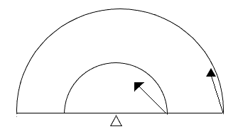

Moment of inertia where mass and torque are at a different positions
In summary: That's because torque relates to work, while Newton's second law doesn't. The moment of inertia depends on both concepts. For Newton's second law it doesn't matter where you apply the force. For work it does, because you can do more work if you use a lever, for example. And when you have a lever, you can put the mass (which can be a point mass, for simplicity's sake) at the end of the lever - where you apply the torque, or closer to the pivot point of the...

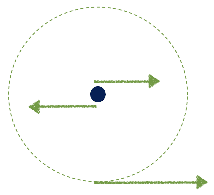

  • #39
etotheipi said:
For the case of the wheel of an accelerating car, the friction force points in the forward direction to accelerate the car which also has the upshot of opposing the torque produced by the axle.
First the equivalent force was wrongly posted as ##F=\tau/RF##, it should be ##F=\tau/R##. My apologies for the typo.
The wheel shown in my drawing rolls without slipping to the right and has CM acceleration ##a_{cm}##. Undeniably the net force on the CM is ##F_{net}=ma_{cm}##. Can we identify this net force with the force of static friction ##f##?
If "yes" then it must point to the right. But if it points to the right, the torque about the CM is out of the screen (counterclockwise) which contradicts the assumption of forward linear acceleration which implies clockwise angular acceleration. Therefore the answer must be that the force of friction is cannot be identified as the net force on the CM. This means that there must be an additional force, call it the engine force, ##F##, what I call the "equivalent" force.
Now imagine a FBD similar to the one I showed in #37 except that the arrow representing ##f## has reversed direction and points to the right. Reversing the arrow's direction means that one needs to reverse the algebraic sign in front of ##f##, which represents the magnitude of static friction, in all the equations where it appears. This will result in$$f=-\frac{I_{cm}}{(I_{cm}+mR^2)}F.$$Because ##f## and ##F## are both magnitudes, if we insist that the force of friction is correctly drawn, we must assume that ##F## must be incorrectly drawn and therefore must point to the left. this last result says that the choice of direction was incorrect and that it should actually point to the left. This is consistent with the definition of ##\vec F## as the force that generates a torque about the CM such that ##\vec \tau=\vec R \times \vec F## where ##\vec R## is from the CM to the point of contact. In #37 I considered the torque about the point of contact. Since friction generates no torque about that point, ##F## must be in the forward direction. Both pictures agree on the direction and magnitude of ##a_{cm}##.
(I edited this post to remove material that was not correct.)

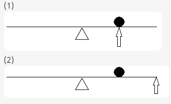

  • #41
etotheipi said:
If you fix the moment of inertia then you're right, ##\tau = I\alpha## so a larger torque yields a larger angular acceleration.
If we instead fix the tangential force, then the angular acceleration is greater for smaller radii (even though the torque of the force at the larger radius is larger!).
Let me go back to my original scenario, hopeful this will make things clearer (sorry for all the back and forth - I'm trying to wrap around my head around a number of concepts at the same time I guess):
(1)
(2)
Assume the see-saw thing has no mass or friction. Further, assume that the forces are of the same magnitude in (1) and (2). The tangential accelerations should, therefore, be the same in (1) and (2). Likewise, the moment of inertia is the same between (1) and (2) since the masses are in the same position.
However, the torque of (2) is double that of (1). Therefore, the angular acceleration of (2) should also be double that of (1). Analytically, in (2):
2τ = I(2α)
2rF = m(r^2)2(a/r) = 2rma
F=ma
In other words, in (2) the angular acceleration is double that of (1), but the tangential acceleration is the same.
Here’s my problem. If masses (1) and (2) are in the same position, how can their tangential accelerations be the same but their angular accelerations different?
  • #42
What makes you think so?
  • #43
This is not so. When there is angular acceleration, you get the tangential acceleration from ##a_t=\alpha r## instead of asserting what it is using ##F_{net}=ma##. That's because the CM is not free to move in a straight line, but is constrained by the pivot to go around in a circle. I showed you how to handle this in post #8. The general strategy is (a) find the angular acceleration of the rigid body about the pivot using ##\tau=I\alpha##; (b) find the linear (tangential) acceleration of any point on the rigid body using ##a_t=\alpha r##.
Here, the tangential acceleration is $$a_t=\alpha~L=\frac{\tau}{I}L=\frac{Fr}{mL^2}L=\frac{Fr}{mL}$$ where ##L## is the distance of the mass from the pivot. In the top picture (1) ##r=L## so that ##a_{1t}=\dfrac{F}{m}##. In the bottom picture (2), ##r=2L## so that ##a_{2t}=\dfrac{2F}{m}##. Note that the angular acceleration is twice as much in (2) than in (1) because the torque is twice as much and the moment of inertia is the same. Then for the same position of the mass, the tangential acceleration is also twice as much in (2) than in (1).
Likes ynbo0813, etotheipi and Delta2

Many thanks for the explanation. I agree with all of your analysis, but it still seems to me like the force ##\vec{F}## is a contact force between the axle and the wheel in your example and the setup is such that the axle can transmit no torque. This is completely valid, and demonstrates rolling also, though not what I was imagining!
I imagined a FBD like this, with the torque from the axle equivalent to a force couple exerted by the axle on the wheel:
Then we can identify the static friction force ##\vec{f}## as the forward force providing ##\vec{a}_{CM}##, however we must also have that the clockwise torque of the couple is greater than the anticlockwise torque of the static friction, i.e. ##\tau_{couple} > fR##. That provides the clockwise angular acceleration and with the constraint ##a_{CM} = R\alpha## we can then solve the system.
I haven't the faintest clue how cars are actually designed, though I presumed it was a force couple (or equivalent) that the axle exerts on the wheel and not a forward contact force. In reality, it probably does both, and we need to draw a couple in addition to a contact force from the axle! 😁

Ok so I think I may have got it, but I'm not sure. Please correct me if I'm wrong.
Going back to my diagrams in #41:
In addition to the force illustrated, there is the centripetal force. The centripetal force is bigger closer to the pivot point (because F=(mv^2)/r). The vectors for the forces should then look like this (apologies for the poor quality - I'm just using paint):
(1)
(2)
In (2) the net force is more in the direction of the tangent circular motion. This is why the net force, and therefore the net tangential acceleration, is greater in (2).
This might also provide the intuition I was looking for: why the force is 'magnified', so to speak, by its distance to the pivot point.
However, I suspect I may be completely off the mark here, so please correct me :smile:
