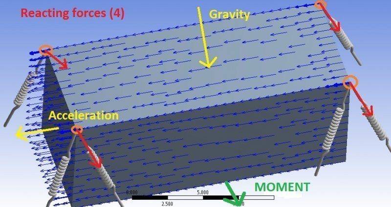

Setup/Verification (See attached Reaction_Forces picture):
  • Body in motion being held down by straps.
  • Uniform Center of Gravity (CG) in model.
  • Reaction forces (in red) are found in top 4 corners, x,y,z for each.
  • Moment Force is verified by summing cross product of each force reaction (x,y,z) and its relative locations from body CG. Resulting moment is 0.5% off my program approximation. Great!
    • [reaction 1 cross product] + [R2 crossP] + [R3 crossP] + [R4 crossP] = One axis moment reaction. Perfect.

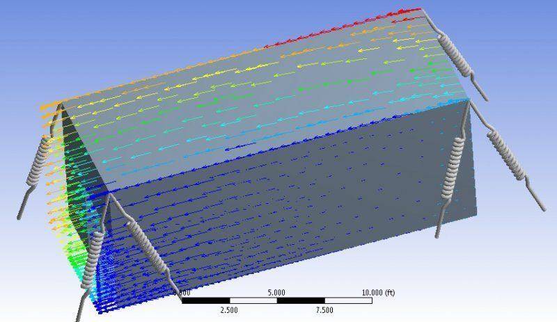

Problem (See attached NEW_CG):
  • Same body in motion. CG is now offset from exact middle of body. New CG.
  • Reaction forces adjust accordingly as expected. Nice.
  • Moment is predicted by program with a sizeable addition in one of the 3 axis.. Roughly equivalent total though.
  • Hand calculated Moment, using same method as above with cross product of reaction forces and relative locations from NEW CG, is completely wrong. 55% wrong.
    • Are there more than 4 reaction cross products now?
Is there something I'm not taking into account? The body is now rotating slightly, I understand there will be 2 axis forces for moment now.. But my hand calculations are so far off I feel like I'm missing something.

I presume the box is standing on something? I cannot see an upward reaction force.
I apologize, yes, there is a normal force reaction and the box is sliding across a frictionless floor.
Did I post this in the correct forum? I haven't been able to figure this out yet.. Approaching the problem correctly is my greatest concern. I don't know how to account for the added rotation of the box do to the offset center of gravity. Anybody have any advice for me?
