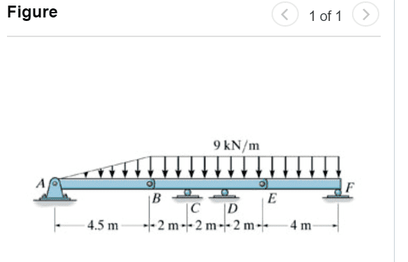

How come the pins at B and E don't affect the shear or moment diagram?
Because there are no vertical forces applied to the ABCDEF system there.
