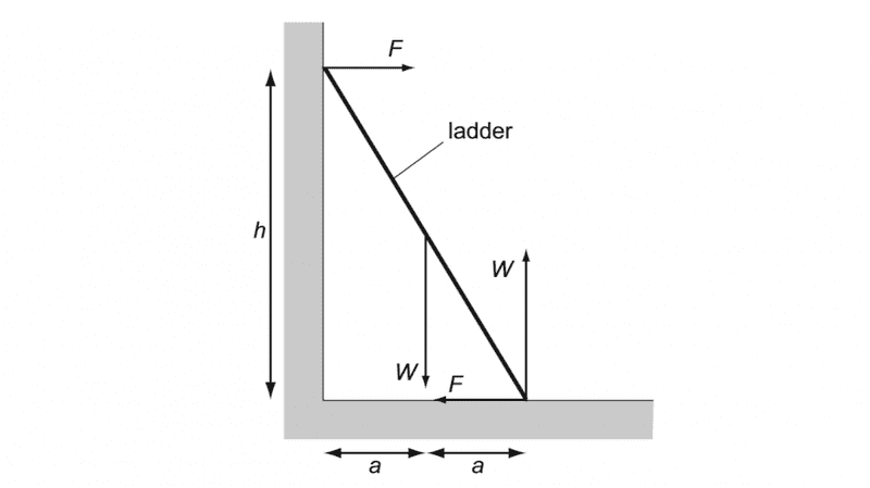

A uniform ladder rests against a vertical wall where there is negligible friction. The bottom of the ladder rests on rough ground where there is friction. The top of the ladder is at a height h above the ground and the foot of the ladder is at a distance 2a from the wall. The diagram shows the forces that act on the ladder.
Which equation is formed by taking moments?
(A) Wa + Fh = 2Wa
(B) Fa + Wa = F h
(C) Wa + 2Wa = Fh
(D) Wa – 2Wa = 2Fh
moment=F x perpendicular distance
Should the answer be (C)?
The anticlockwise moments are Wa and 2Wa and the clockwise moment is Fh, so they should be equated.
But which is the pivot? Is the pivot one of the ends of the ladder or some other point on the ladder. Shouldn't the forces have to be split into components because the force and distance must be perpendicular to each other. And shouldn't the distance be taken along the length of the ladder and not the ground?

The answer given is (A)
Around which point is the ladder going to rotate? Around the centre of gravity or does it rotate around one of the ends of the ladder? Where is the hinge of the turning effect located?
Priyadarshini said:
Should the answer be (C) [Wa + 2Wa = Fh]? The anticlockwise moments are Wa and 2Wa
No. Those two moments are only in the same sense if you pick an axis between the two forces. But then the distances a and 2a will not both be right.
Taking an axis at the base of the wall, the ladder's weight has a clockwise moment and the reaction from the ground has an anticlockwise moment.

In the diagram, there are two forces magnitude F and two magnitude W.
In equation A, there are moments Wa, 2Wa and Fh.
Clearly the Fh moment must be a result of one of the two F forces and the other F force has no moment. This leaves only two possibilities for the Y coordinate of the axis. What are they?
Similarly, to get those two moments from the two W forces, there are only two possible values for the X coordinate of the axis.
Finally, see if any of those four X, Y combinations give the right signs.
Edit: That said, it's probably quicker just to pick a fairly obvious axis, work out the balance of moments equation for yourself, and see if it can be manipulated to match one of the given equations.

The F that acts along the horizontal at the base of the ladder has no moments. So the two possibilities for the Y coordinate of the axis is along the point on the ladder where its weight acts (W) or through the foot of the ladder where there is a force of W.
And the X coordinate acts either through F (the one at the upper tip of the ladder) or through the centre where its weight acts.
So the axis of rotation is through the W in the middle of the ladder?
But then where does 2Wa come from?

Seems like you do not know how to take moments. Let's try a specific example. Suppose you pick the point where the floor meets the wall. For each of the four forces, how far is its line of action from that point? What four moments do they result in?

For the ladder, I think I understand how it works.
For the example, the forces acting is the weight of the ladder acting downwards and the normal reaction force that acts upwards, friction acts at the point and the other force is opposing this, right?
How about considering the origin (say, vertical is y-axis and horizontal is x axis) as the point of rotation of the rod?
Clearly :
1. The force acting horizontally at the ground will not produce any moment.
2. The force at the height h will produce moment Fh in clockwise direction.
3. The weight acting at the center of the ladder will produce moment Wa in clockwise direction.
4. The weight acting at the end of the rod will produce moment W(2a) in anti-clockwise direction.
You can deduce the result from here, right?
And for how to solve such questions - Always prefer to imagine the situation and taking the origin as the pivot point and try to deduce equations accordingly. You can also try to work out by taking other points as the point of rotation and see the difference in the result.

Yes, those are the forces, but what moments do they exert about the point where the floor meets the wall?
Let's just start with one: what moment does the normal reaction from the floor have about that point, and in what direction?

No, the normal force from the floor acts where the ladder meets the floor. The point I specified is where the wall meets the floor. Did you misread my question?
Are the moments Fh, Wa and 2Wa?
Yes. Which ones act which way?
Fh and Wa act in the clockwise direction and 2Wa acts in the anticlockwise direction.
Right. So which equation does that match?
Option (A)! Thank you!
