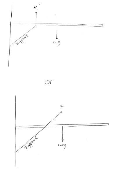

This is more of a question of applying the correct principles to a range of problems involving a horizontal rod hinged to a wall that is then supported by another rod. The support rod is also attached to the wall from above or below and then attached to the horizontal rod, so it is at some angle to the horizontal direction.
My question is about the forces that act on the horizontal rod from the support rod. If the support rod is attached below the horizontal rod, then the horizontal rod experiences a force supplied by the support rod, which acts parallel to the support rod.
My question is, in addition to the force the force supplied by the support rod, is there also a normal reaction force that also acts on the horizontal rod at the point where the support force is in contact with the horizontal rod?

Hi Haruspex. Taken me ages to reply. Busy time of year!
Following off from your last message, if we assume the main rod is perpendicular to the wall but the support rod is not perpendicular to the main rod, how would I accurately consider all the forces acting on the main rod if I was going to take moments about the hinge?
I have only the main rod's weight and the force supplied by the support rod. Given that the support rod is not acting on the main rod at 90 degrees but at some other angle, how do I model this support force? Does it act perpendicular to the main rod? Does it act in the same direction of the line of the support rod? And is there a reaction force due to the main rod's weight on the support rod? Is this the same as the support rod's force?
I've attached a diagram to illustrate.
In general the support rod will exert a horizontal and vertical component at the point of contact. Now the resultant of the two will not necessarily be along the rod. The vertical component varies with distance from the pivot. You can see how that is if the horizontal rod is supported by a vertical string from above instead of from below at distance x from the pivot. The tension (and the vertical component supplied by the support rod) is T= mgL/(2x). Of course, the wall provides a vertical component Fy such that T + Fy = mg.
What about the horizontal component? The details of how the support rod makes contact with the horizontal rod cannot be ignored. Suppose you are told that the contact between the support rod and the horizontal rod is frictionless so there can be no horizontal component. Can the horizontal rod be in static equilibrium? Yes, because horizontal forces are not needed to maintain static equilibrium. This assumes that the support rod is firmly screwed to the wall otherwise the net torque on it cannot be zero. A frictionless contact can be simulated by attaching a small wheel at the end of the support rod that's in contact with the horizontal rod. Will the wheel turn?
As I wrote, it depends whether the support rod is weightless. Let the reaction force be R and the weight W. Take moments about the point where it meets the wall. Only W and R have a moment about that axis so must have equal and opposite torques. If W is zero neither have a torque, so R must be along the line of the rod.
Conversely, if W is nonzero then R must have a component normal to the rod.
As I understand it, the two rods are freely jointed.
Yes, my intention was to indicate that there are more than two possibilities for the direction of the force exerted by the supporting rod.
Sorry, I don't get it.
A frictionless joint would just mean that there is no torque transferred at the joint. It does not prevent there being a horizontal component to the force.
Sorry, I did not explain myself very well. I was thinking no joint or hinge at the horizontal rod contact, just support from underneath.
