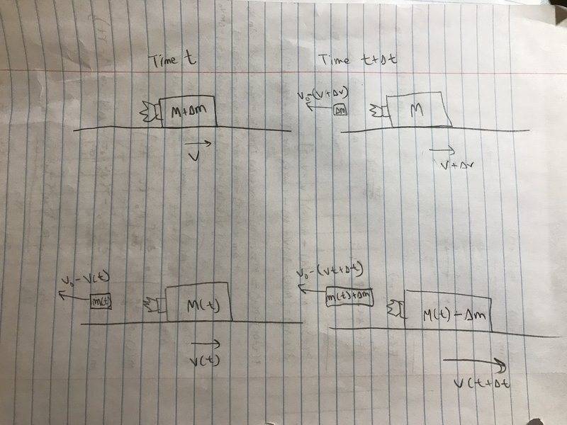

A rocket sled moves along a horizontal plane, and is retarded by a friction force friction = μW, where μ is constant and W is the weight of the sled. The sled’s initial mass is M, and its rocket engine expels mass at constant rate dM/dt ≡ γ; the expelled mass has constant speed v0 relative to the rocket. The rocket sled starts from rest and the engine stops when half the sled’s total mass is gone. Find an expression for the maximum speed.
d(mv)/dt = F(x)

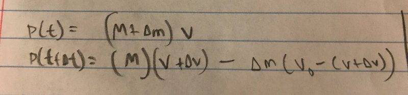

To solve the problem, I found the differential equation for momentum, taking the momentum at a point in time and then the momentum a moment later, then dividing by a change in time.
This interpretation worked.
This interpretation did not work.

I do not understand how you obtained the first equation of the second method. What is your reasoning?

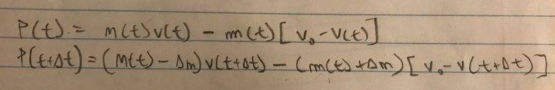

I set up a differential equation for the change in momentum in a small change in time, according to the diagrams below. The second setup, when I solve, gives the wrong answer.
In the lower left diagram, you have a mass m(t). This appears to be the total mass of fuel burnt so far. But you do not know its total momentum. It is not all at velocity v0-v(t) since v(t) has been changing.
Likes ecoo
I see what you mean, but isn't that taken care of when we have change in time approach 0 (this is my next step to find an expression for change in momentum). And why would that not also apply to the first scenario, where fuel is also leaving while the rocket accelerates?
Perhaps, except that if you expand the second equation you find a term m(t)v(t+Δt). That is multiplying the fuel already burnt by the increased velocity, which doesn't make much sense.
Likes ecoo
Thank you for the help. I now understand what you were saying before.
