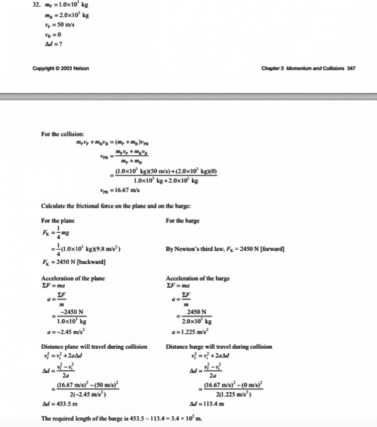

A 1000 kg plane is trying to make a forced landing on the deck of a 2000 kg barge at rest on the surface of a calm sea. The only frictional force to consider is between the plane’s wheels and the deck; this braking force is constant and is equal to one-quarter of the plane’s weight. What must the minimum length of the barge be for the plane to stop safely on deck, if the plane touches down just at the rear end of the deck with a velocity of 50 m/s toward the front of the barge?
F=ma
p=mv
Kinematic equations.
Although I'm not sure where this one will be used...
mPvP +mBvB = mPvP'+mBvB' Where ' represent final condition
Also possibly KE=KE'------ Not sure if elastic?
[/B]
The frictional force the plane and boat will experience is 2450N (by Newtons third law, equal and opposite)
Lets set rear of boat to be - and the direction of travel of the plane to be +
By F=ma,
the plane will accelerate at -2.45m/s2
and the boat will accelerate at 1.225m/s2
Im not sure where to go from here. This is meant to be a momentum question yet I don't see where that would be applicable. Also the question does not specify weather the point at which the plane collides with the boat is elastic or inelastic.

Are you questioning if the plane will bounce back up?Anyway, you know the accelerations of both objects and you know the initial and final speeds of both objects. Can you then find the distance each object travels? Then can you use this information to find how long the barge must be?

Here is the textbook solution. I can't make sense out of the collision part: They're taking the collision to be completely inelastic which is also confusing me.
Looking at the solution is a waste of a problem :frown:
They are not taking the collision to be inelastic, they are simply finding the final speed of the boat and plane.
The final speed is when they both have the same speed (because then the plane is at rest relative to the barge).

I see what you saying, I think I'm just confusing myself with the frame of reference. However I don't see how they were able to find the final relative speed (16m/s) using momentum. Could you perhaps explain?
Okay, you already have this equation:
We know that vB = 0 and vP = 50 m/s and we know both masses. We just don't know the final speeds of both objects.
The key thing to realize is that, in order for the plane to be at rest relative to the barge, they must be moving at the same speed.
When the plane "stops on the barge," it is moving at the same speed as the barge.
Therefore v'B=v'P which I will call vf (the final speed of the system)
So your conservation of momentum equation becomes mPvP=(mB+mP)vf which can now be solved for vf
(You need vf to find how far the plane and the barge each travel during this process of stopping.)
