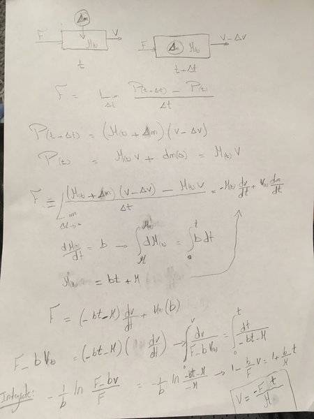

An empty freight car of mass M starts from rest under an applied force F. At the same time, sand begins to run into the car at steady rate b from a hopper at rest along the track.
Find the speed when a mass of sand m has been transferred.
attached
attached
The solution answer has an extra b*t in the denominator and + answer. Where is the flaw in my method? Now I understand this can be done shorter using impulse and exact values but I prefer the more general approach and deduce specific cases at the end. Thanks

Why do you have v-Δv instead of v+Δv?
There are some terms that are rather blurry in the image. Looks like erased or half erased. In particular, you seem to have a v0b term which should be a v(t)b term, i.e. affected by the varying velocity.

Sorry it just takes lots of time to type and I work out lots of problems so trying to use time efficiently!Next time I will use ink and make it more neat apologies.
as for v-Δv due to the added mass shouldn't the velocity decrease according to Conservation of Momentum. Wrong? I tried changing the sign but that only switches final sign and does not produce right answer.
There is no V0, it is meant to be V(t) sorry
What makes you think that ##\Delta v## cannot be negative? A good way to avoid sign errors is to always define the change in something as positive when that something increases. Like haruspex, I have real problems reading what you have written so I cannot help you more than that since that is all you typed out.
It should have fixed both problems. Please post your reworking (typed!)

I got the right answer thank you so much for your help.
