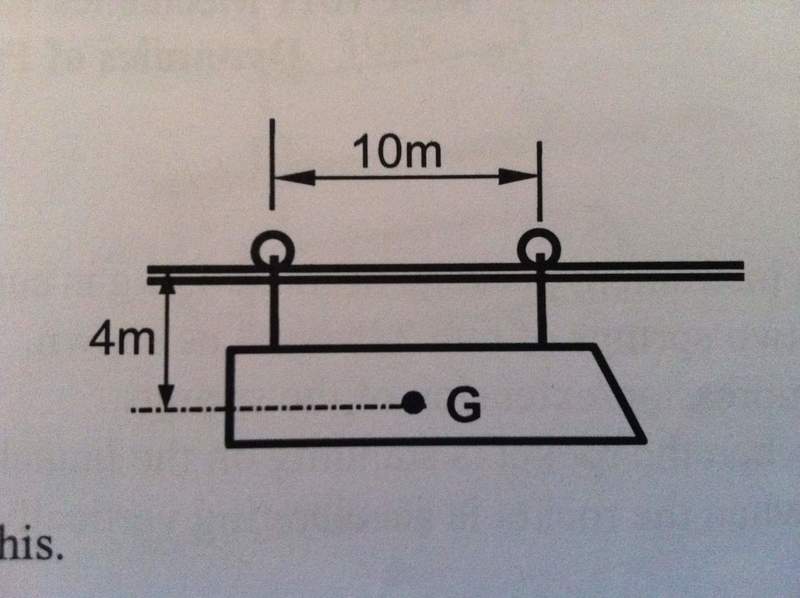

Hi, this problem’s been bugging me for ages. I’m sure it’s just a simple misunderstanding somewhere on my behalf but I just can’t seem to get my head round it.
A monorail car with front wheel drive and mass of 5 tonnes is suspended from two wheels 10m apart as shown. Its centre of mass G is midway between the wheels and 4m below the rail.
Starting from rest, the train is designed to achieve a maximum speed of 20km/h in 40s with uniform acceleration. Calculate the minimum coefficient of friction between the front wheel and the rail to achieve this.
Part 2
Determine the acceleration that could be achieved with the same coefficient of friction if rear wheel drive was used, and hence the time to reach 200km/hr.
The answers given are 0.254 and 49.1
I've attached a photo of the diagram.

Consider that the force that drives the monorail forward is not acting through its center of mass. Rather, the friction force of the tires on the rail acts horizontally above and to the front (or rear) of the center of mass. There will be components, moments, etc., to consider. What center would you choose for moments affecting the normal force acting on the drive wheel? What forces produce those moments?

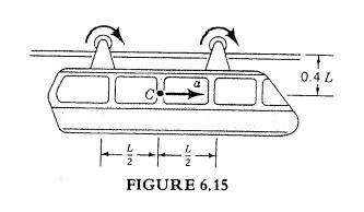

Hello everybody
I have a problem of monorail but I can't solve it.
Please could you help me?
I have a problem to solve as follows:
A monorail system consists of a car suspended on a horizontal cable.
The car is driven by one of the wheels. If the coefficient of friction
between the driving wheel and the cable is µ=0.5.
Determine:
1. which of the 2 wheels will cause a movement of the car?
2. calculate the maximum acceleration.
thank you.
How I can know the driving wheel?
The monorail car is suspended from two wheels with distance L. Its centre of mass G is midway between the wheels and 0.4L below the rail.

infolil said:
Thank you
This thread is very interessant but we haven't the same problem.
I attached the statement . May be, this will more clear but I haven't other information.
Ah! That's different! The wording is asking you to determine which would be the better wheel for driving the car. You'll have to determine which wheel would allow for the most acceleration without the drive wheel slipping. It will involve writing equations for moments about different points in order to determine the normal forces that act between the wheel and cable for the two situations.

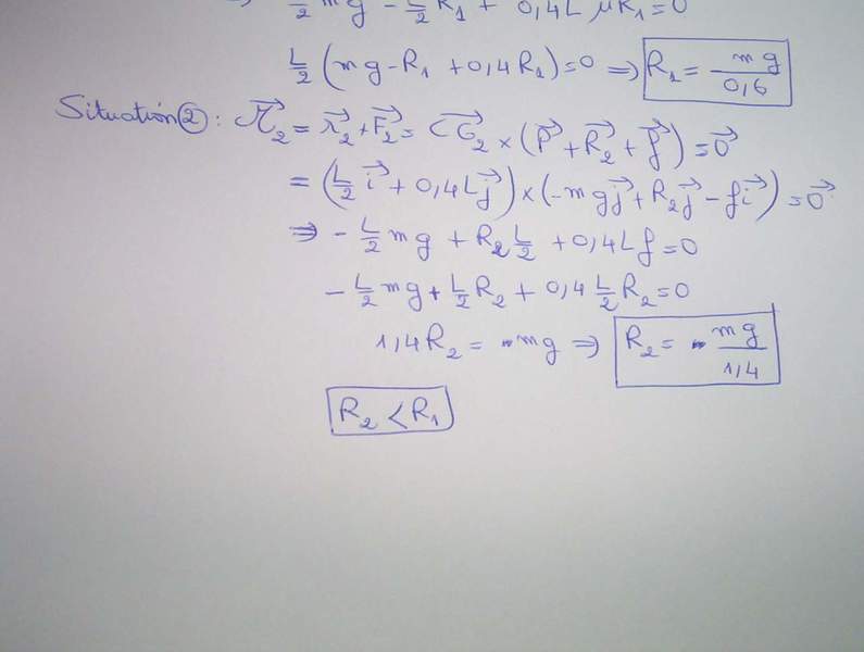

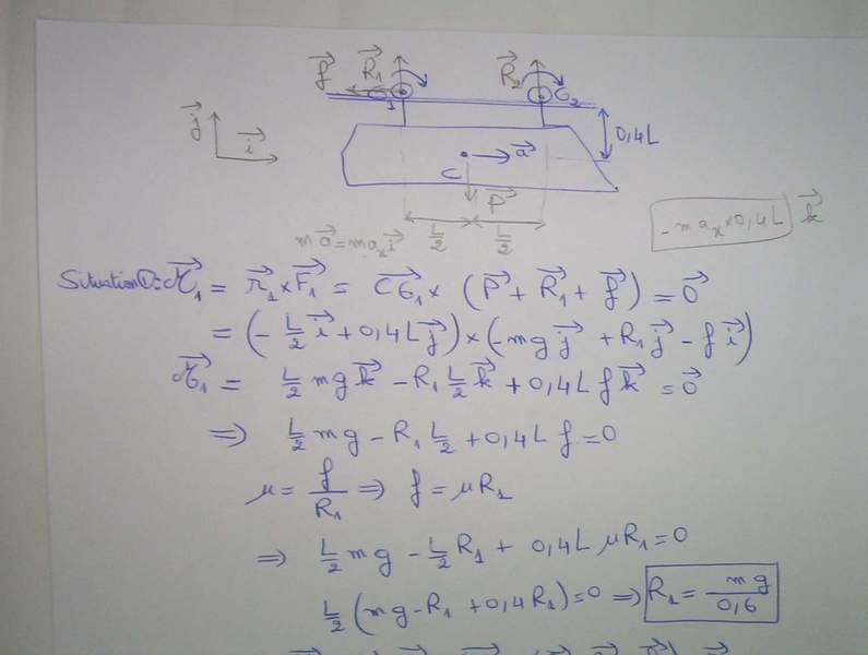

Thanks
I tried. Is that fair and I'm in the right direction?
I think you've got the right ideas. If I recall correctly from when I looked at this thread back in August, I found that front wheel drive was the better choice.
