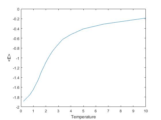

Lo,Im stuck on how to retrieve the specific heat capacity from an MC simulation, with the metropolis algorithm. I want my graph to look something like this:

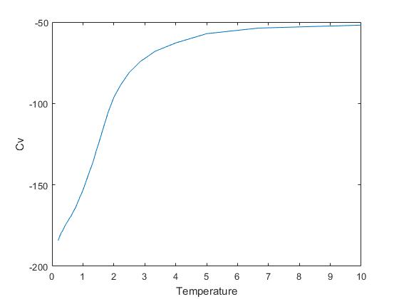

To retrieve C_v i wrote the following code to 4:19 from the video above.
Cv = (E2/16384 - E.*E/16384^2)./(T(i).^2);
plot(T,Cv);Where E2 is given by the code:

However my graph looks more like the plot of <E> vs T.
No, I am still stuck atm. Cant get any reasonable graph. Is there someone that have done this type of simulation before ?
Someone that knows what iam missing ?
