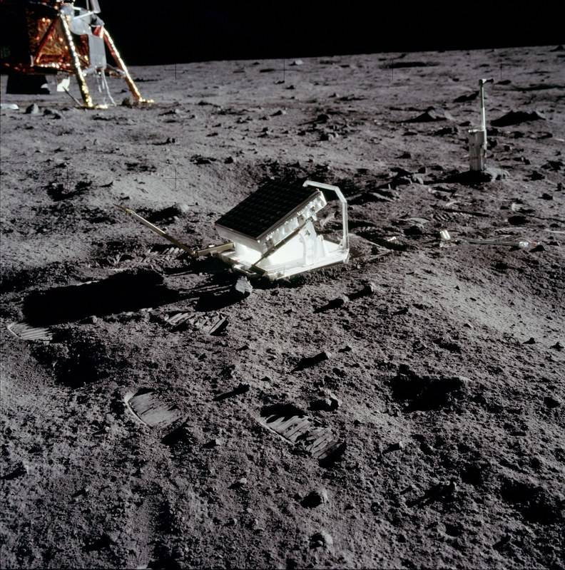

moonbounce said:
I am really interested on doing a moonbounce approach. This is more cool and seems to offer certain level of challenge. Lol.
I am going to register to a ham regulation office in our country in the next few days to start.
If you really want to do that, I suggest that a laser is better than a HAM radio. Apollo 11 conveniently left a mirror on the Moon for use by us Earth-bound beings.

Yup. I will be working as a amateur ham radio :)
For the laser concept, i think it is ok for laser ranging for moon distance. Correct me if I am wrong but the mirror is for retroreflective applications. Can I bounce the laser on a different location? Waaaahh. Another ambitious goal. Haha.
anorlunda said:
a laser is better
Can you use a laser any time exacept the new moon?
