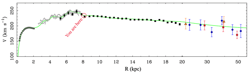

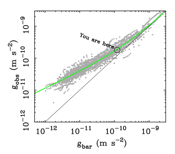

An example may help. Imagine a disk-galaxy.
In the central part of the galaxy, the acceleration on local stars towards the center of the galaxy from the Newtonian gravitational pull of the galaxy exceeds a0 and there are no MOND effects of any kind on stars in that part of the galaxy.
Beyond that ring, the acceleration on local stars towards the center of the galaxy from the pre-MOND Newtonian gravitational pull of the galaxy is below a0 and MOND has the effect of increasing the acceleration on local stars towards the center of the galaxy to a0.
If wide binary stars were in a void in deep space, isolated from any nearby galaxies that could create an external field effect, and at a distance where their Newtonian gravitational pull on each other was 0.1 a0, MOND would predict that their gravitational pull on each other would produce a gravitational acceleration of a0.
Suppose that at a particular radius out from the center of the galaxy, the pre-MOND Newtonian gravitational pull of the galaxy is 0.5 a0. Then, at that radius out, roughly speaking, MOND effects between wide binary stars won't exceed 0.5 a0, even if the gravitational pull of one wide binary star on another is only 0.1 a0.
The wide binary stars that are being studied for MOND effects are in parts of the Milky Way in where the the pre-MOND Newtonian gravitational pull of the galaxy is less than a0, but not negligible, so there is a significant External Field Effect that needs to be accounted for.
