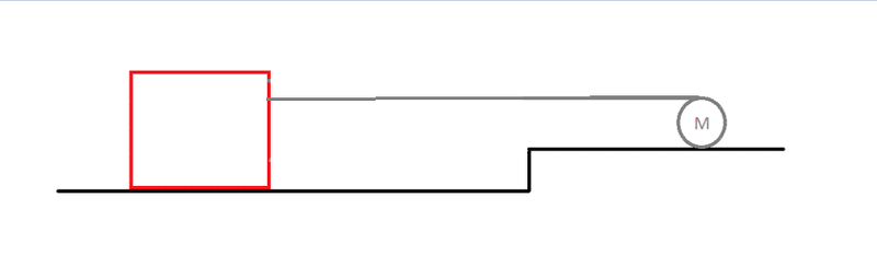

I'm in my first year of university, studying industrial engineering. On a test I got the following image:
The red square is a block with a specific mass, the grey lines are a string, the circle with an 'M' inside is a motor that rolls up the string, and the other red circles are pulleys.
for the test,we had to calculate the power of the motor on the block after a specific amount of seconds. The power of the motor, the mass of block and the coefficients of friction between the block and the ground were given, and we were allowed to neglect the friction between the string and the pulleys. (also, the block cannot rotatate or something, you can view it as one "particle")
I'm not going to ask you guys to solve this problem, but I just have a question about it:

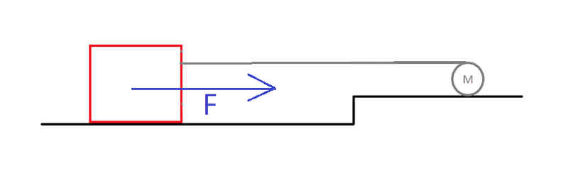

The motor will give the block a specific force with a direction towards the motor, but if the motor would be directly connected to the blok, without any pulleys (see image below), would the force on the block be the same, will it be larger, or smaller?

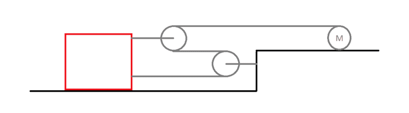

On the answer of my test, the force would be larger with 2 pulleys than it would be when the motor is directly connected to the block, so the more pulleys, the stronger the force of the block towards the motor. But I don't really understand why, isn't that a little bit illogical? because if that would be true, we could, in theory, connect 1000 pulleys to the block, and then we could move a very heavy block with just a tiny weak motor, because the more pulleys, the stronger the force. That's a little bit strange, no?
Thanks in advance.
Anthony

Thank you for your answer.
if the force on the block, when the motor is directly connected to the block, be for example 1 Newton. How much mould the force be on the block be when there are 2 pulleys then? How much larger would it be?
Anyway, it still doesn't feel right for me. So this means that I would be able to move an entire house with just the motor of my ceiling fan, as long as I use enough pulleys?

I think you will have a force three times as big, because your motor will have to do 3 times more rotations to move the block the same distance as if there would be no pulleys, but I'm not really sure abut this.
That's one way of coming at the answer. Another way is draw a diagram with all the forces (force of each length of rope on whatever is at each end, force of the pulley supports on the pulleys, force of the motor on the rope, force of the ground on the motor) and work out the net force on the pulleys, block and motor. The motor and the pulley fixed to the ground are not moving, so you know the net force on them must be zero.

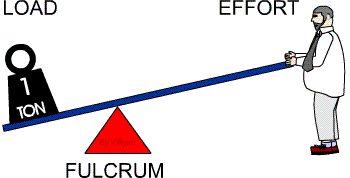

You may not believe it, but you know all about this already. Just look at the similar situation for a fulcrum-lever system:
Here, you can already see that a smaller force can be applied to lift a heavy object.
The trade-off here is that you apply this smaller force over a larger distance, so that the total work done by the heavy weight is the SAME as the total work done by the force lifting it. It is not the "force" that has to be "conserved", but rather the total energy in the form of work done.
This is no different than the pulley system. You can apply a smaller force, but you have to apply it through a longer distance than the object you're lifting.

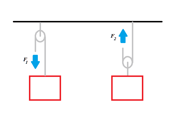

Example:
If the 2 red blocks have the same weight, then ##F_1 = 2F_2##. Just a single pulley in both cases.
