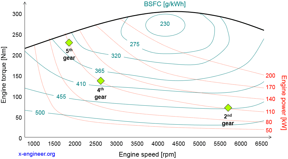

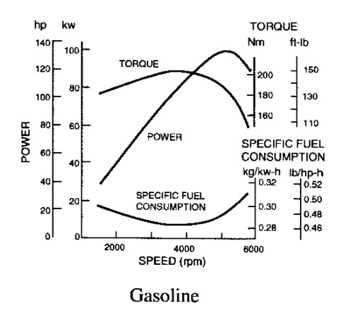

Couple of miss conceptions. ICE engine speed and fuel consumption. Internal combustion engines to varying degrees are tuned resonant systems. That is the inlet length and exhaust length, and valve timing etc play a huge role at how good an engine is at converting fuel to mechanical work at a given rpm.
Contrary to common belief, there is an optimal speed for power production, you loose efficiency operating above or below this speed. Caveat here is parasitic loads, if at a higher speed these parasitic loads exceed significantly your actual load then running slower will be more efficient.
Image below (specific fuel consumption) shows you that optimal speed for this engine from an efficiency stand point is ~3800rpm.
Re total fuel starvation, only diesel can do this without problem, I'm fairly sure gasoline engines need to maintain fuel/air ratios correctly other wise bad things happen*.
* Direct injected gasoline engines may not have this issue, and can likely completely shut off fuel without problem.
Also don't trust your "mpg" gauge etc in your dash to really show you what's going on, my car will indicate 0L/100km if I lift off the gas completely, yet the data from the cars computer on my OBD2 device definitely shows a non zero fuel delivery rate at the injectors.

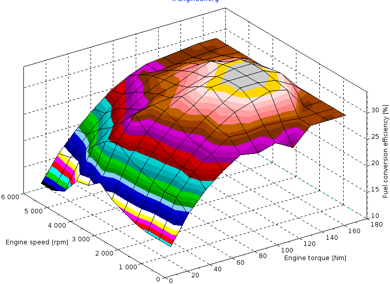

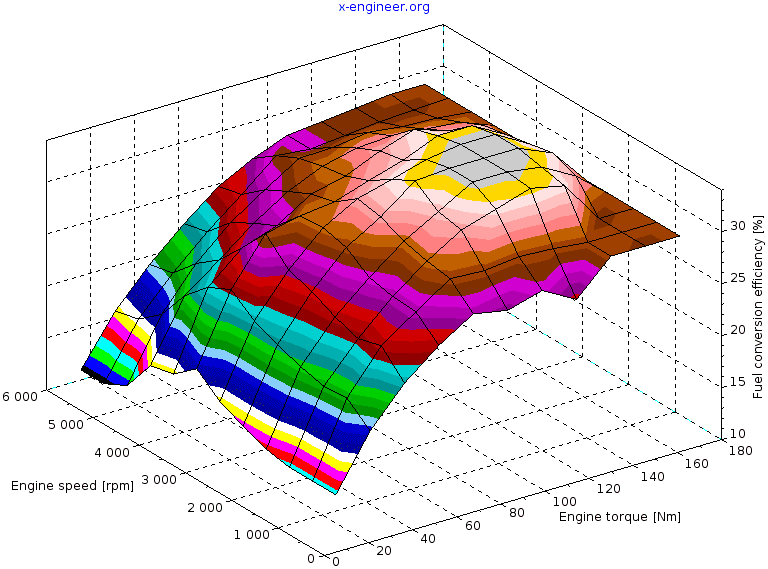

This question:
1. What determines fuel consumption, the amount you depress the gas pedal or your engine's RPM?

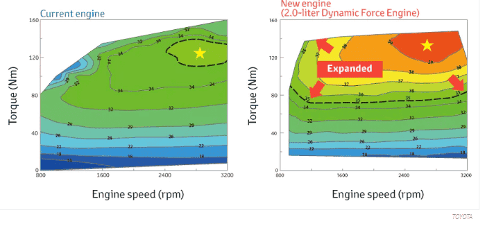

That image is a simplification, but it does highlight that engines are quite complicated beasts, and speed and efficiency are linked in interesting ways. I do believe you a right that this was a "WOT" chart.
From what I understand for a NA diesel, since air flow is always "wide open", engine RPM has large impact on combustion efficiency due to tuning of the valve timing and resonances in the inlet/exhaust.
For a gasoline engine where throttle position affects air flow, actual efficiency map will be a bit more complicated* with at minimum a surface with output power being one variable.
The condition I'm talking about, getting much better in modern engines with variable every thing timing, is shown on the upper left of the "current engine" chart, at low speed, as torque exceeds a point, efficiency stops increasing and reduces again, this "hump" gives you multiple operating points at a given power with the same efficiency, at different engine speeds, depending on how much power you need...
What should be really clear though, generally operating an engine at light load regardless of speed is terrible for efficiency. This is the science I claim as the justification for why I PWM my throttle... :oldbiggrin:

As for BSFC maps, this one should be of more help:
As you can see, for any constant power with respect to RPM (red lines), the BSFC tends to increase with RPM (except maybe close to WOT, near the lowest BSFC). Even though you can achieve the lowest BSFC at about 4200 RPM , close to WOT, that correspond to a certain (very high) power output. The '50 kW' line is closer to what needs to be considered for cruisin' speeds.
So at anyone power output, there is a single optimum operating speed, if the power demand changes, that optimum operating speed moves up or down. 50kw optimum speed is ~1200rpm, 80kw is 1700, 200kw is around 3700rpm.
Note not sure those power curves are correct? 250Nm @ 4000rpm is only ~100kW (Power (W) = Rpm*Nm/9.5488)
So as your vehicle is driving down the road at constant speed, which with fixed gear box means fixed engine speed. But power requirement is not constant, maybe wind resistance changes, climbing a hill etc, this wants to move the operating speed around to maintain optimal efficiency.
Then as mentioned cruising power is very low 10-15kw average for 100km/hr highway driving, at these low operating powers efficiency is very poor. The 50kW curve (actually closer to 10kW) is basically constant (poor) BSFC from 2000rpm to 5500rpm, but optimal is at the lowest speed this power is achieved with WOT. If you want to operate at cruising speed most efficiently, you need a smaller engine pushed harder, ie the 10kW load line should hit the 230g/kwh blob.
Loading the ICE with a generator under light driving load is something that is done in some hybrid systems if there is room in the battery to try to keep the engine in its most efficient state at a given rpm, which is generally determined by road speed in parallel hybrids.
jack action said:
You are right with that and I'm not sure why it is like that; I just found the image on a search engine. Still, the general shape of the constant power curve stands: As you increase RPM, you must reduce torque equally.
I think the power is somehow scaled against BSFC. The curves are not as smooth as they should be if it were just torque vs rpm; they sag in the lower-left where the BSFC is lowest.
