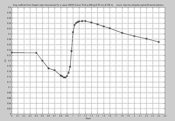

http://www.hornady.com/store/images/P/30731-30-Cal--308-208gr-ELD-Match.jpg
This is a common bullet shape which is very close to optimizing (low) drag for supersonic spin stabilized projectiles.
It's not bad, though it would be better with a more complete boat tail (which it does not have because of the requirements of barrel launching as well as spin stability concerns).

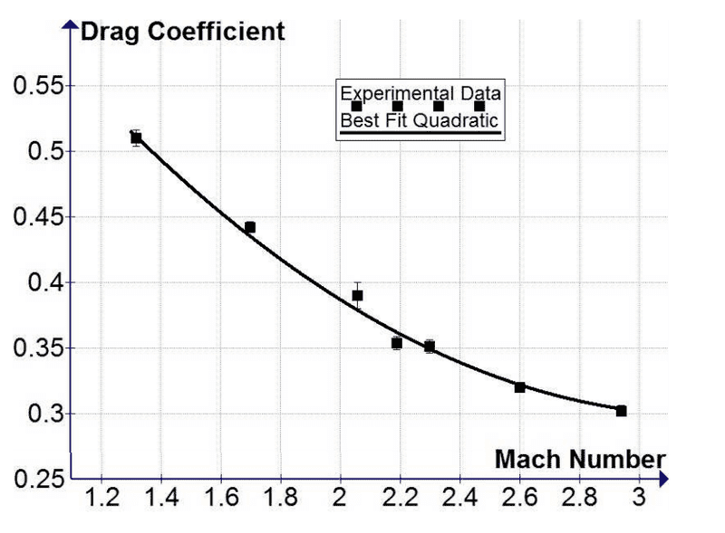

Yes, there is potential to reduce the drag by about 5% more by a more complete boat tail. The longer bullets that result would require a faster twist rate to maintain gyroscopic stability. The longer base would also reduce powder capacity by extending further into the cartridge case. These effects tend to combine to increase peak operating pressures in the barrel without increasing muzzle velocity. There is also the additional challenge of keeping such a design cylindrically symmetric. Imperfections in the overlap between the geometric center and the center of mass create significant inaccuracies as the bullet leaves the barrel. Resulting pitch and yaw also contribute to aerodynamic drag and tend to cancel out the small advantage gained with the longer boat tail.
We measure a lot of supersonic drag coefficients. In addition to the above practical challenges, a fundamental challenge of supersonic bullet design is that the shape that is ideal at the launch speed (usually close to Mach 3) is not ideal as the speed decays down through Mach 2.0 and then toward Mach 1.0. In long range applications, the compromise is to try and optimize the average drag over the supersonic range.

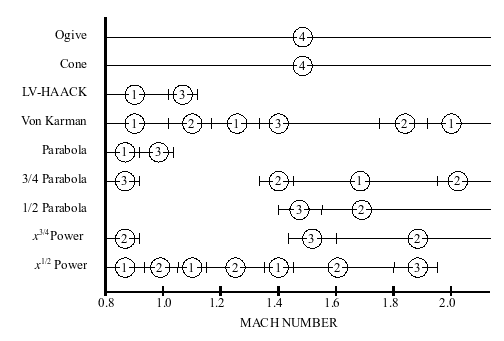

Nose cone shape is of importance.
As usual wiki is a primer.
https://en.wikipedia.org/wiki/Nose_cone_design
which gives the mathematical equations for several types.
Above graph shows the drag with 1 being favourable to 4 unfavourable versus speed.

Some of these appear to flux, like a sine wave. Ie. at Mach 0.9 it has low drag, then at Mach 1 it has high drag, but at mach 1.1 it has low drag again. Is this the natural order of things, or are your statistics incorrect? If your statistics are correct, this would seem to indiciate that air has some kind of inherent frequency, causing wave phase cancellation effects.
The concept is similar to music, timbre, where the air (instrument) has a wide range of frequencies, and when you get close to the concentrated parts, things become either more or less harmonious.
rcgldr said:
Whoops. I can see why you'd draw that conclusion from the sample set I typed in my post. (The article talks about the effects of subsonic vs. supersonic.)
But if you look at the chart it seems to continue even after sonic boom...it goes 0.9 low then 1 high then 1.1 low then 1.25 high then 1.4 low and so forth.
The von Karman almost seem to be symetrrical, with drag highest at 1.5 and then low drag at 1.0 and 2.0. Which the possibilities in my mind makes this seem to be some kind of phase timbre effect, being analogous to sound theory, or the results in the chart are inaccurate.
What I am trying to say is Wikipedia provides a chart like this, implying a simple drag related to the sonic boom.
I'm saying its not so simple, I think its more analogous to this video below.
(can't find it just think of a crazy looking video with sine waves and eq frequencies and such.)
I don't see any video, but one thing to keep in mind is that those numbers aren't telling you absolute drag, they're telling you the relative suitability of the shape for that speed regime. All of those shapes will have an absolute drag profile that looks pretty much like the Wiki chart, but the VK happens to be a bit below most of the others at mach 1, and a bit above the others at 1.5, dropping back down below the others at 2. That doesn't mean that the drag quantity is oscillating however.
