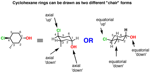

Okay, I attempted drawing out the cyclohexanes. I know that the chair conformation is the most stable cyclohexane conformation so I drew out two chairs.
I know that cis means on the same size so I first drew the chair for cis-1,3-dimethylcyclohexane with two axial methyl substituents both pointing up. This however would create 1,3 diaxial interactions (i.e. crowding with the bulky methyl groups). However, depending on how the ring is numbered, one can have an up equatorial methyl group and an up axial equatorial methyl group. This would eliminate the strain caused by placing methyl groups too close too each other (steric strain).
Similarly in trans-1,4-dimethylcyclohexane, we can have an up axial methyl group and a down axial methyl group. Or if we renumber the ring as to get the most stable/best conformer, we can have a down equatorial methyl group and an up equatorial methyl group. This conformation similarly lacks steric strain.

Re-numbering of a structure does NOTHING to the conformational energies. I hope you didn't really mean that.

Flipping the chair of course changes how the ring is numbered and the axial/equatorial configurations. I hope you know what you're talking about.
Look at your picture again, flipping the ring changes the equatorial to axial and axial to equatorial but it does NOT change the numbering of the ring carbons nor does it change the "up" or "down" assignment. Notice how the hydroxyl is always on carbon #1 and is always "down" although the flip changes it from axial to equatorial. Same for all other substituents.
I do agree with your analysis though, semantics aside, it doesn't seem very easy to compare the two structures. I might be forgetting some detail or other having to do with distances of substituents or something. But I'm getting the most stable conformer containing two equatorial methyl's for the trans-1,4 case and the most stable conformer having two equatorial methyl's for the cis-1,3 case. Are you sure you aren't supposed to compare cis-1,3 vs trans-1,3 or cis-1,4 vs trans-1,4?
You're right! I missed that the cis isomer had both methyls in equatorial positions; I don't know how I overlooked that. Thanks!
