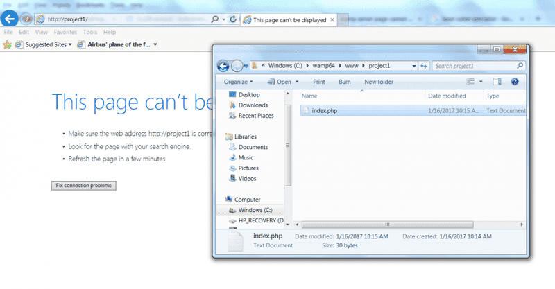

I downloaded wamp. I created a folder called project1 and made a simple index.php file with the contents
<?php
echo "Hello";
For some reason it doesn't work, and localhost is missing from the address. I looked for a solution on Google but they seem fairly complex.

try http://127.0.0.1/ instead
for http://project1/ to work you need to have a hosts entry saying project1 points to your own system.

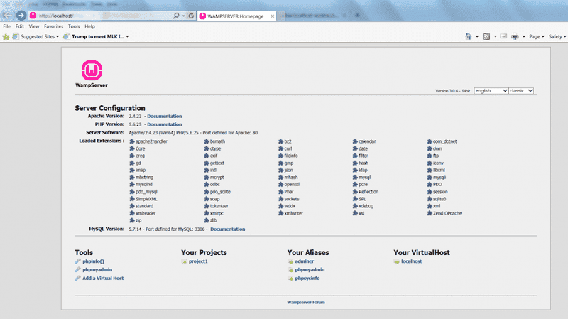

The localhost page shows up without any problem, only when I click project1 I get the "page cannot be displayed"

In the attached image I see that the address reads "http://project1 ". If you put "http://localhost" does the Wamp Server welcome page show up? Then, if you click on "Project1" under "Projects" on this page, (and this includes your php file) does it work? Alternatively, give the full address "http://localhost/project1/index.php".

http://localhost/ takes me to the welcome page, and then when I click project1 it takes me to http://project1/ after loading for a few seconds and saying "Waiting for local host" in the tab

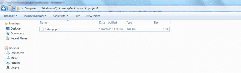

When you saved your file did you put the extension ".php"? Also did you save as not text file?
Yeah but it still didn't work.

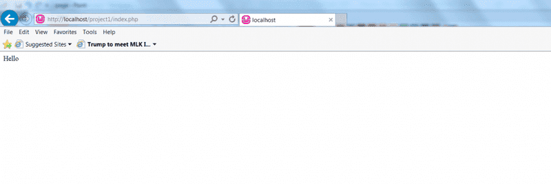

Apparently manually putting in the address works.

I think I found your problem. It is a new concept with WampServer 2.5 (I use 2.1) to encourage creating a Virtual Host for each of your projects. There is also a quick solution (setting $suppress_localhost = false; in 'wamp/www/index.php'). Both solutions are described here.
Yeah, the problem is that your webroot index for some reason is linking to http://project1/
meaning it's looking for a computer called project1. There is no computer called project1. You have a folder called project1 under your webroot
so to navigate correctly to your website you have to type in
or
http://127.0.0.1/project1/index.php
I do not know why your default index.html file generated that link as I've never used wamp
