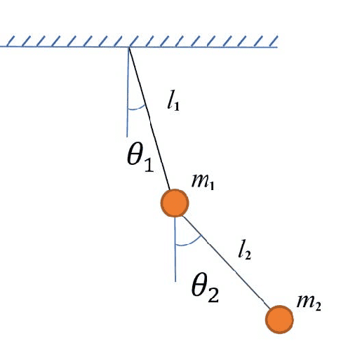

By Lagrange's formalism, the motion equations for double pendulum are:
Using Newton's formalism I can't obtain the second equation. Anyone can help?

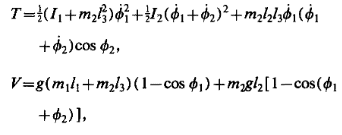

Perhaps a comparable thread (with ##l_2 = l_3##) is :

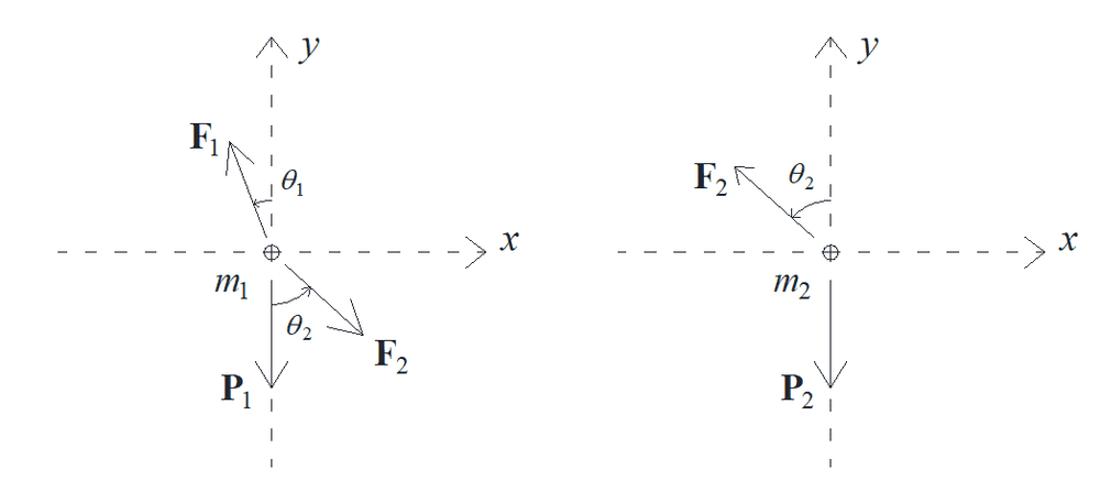

If you want to use the Newton formalism, there are some different approaches you can take. Maybe the easiest would be to write one ##\boldsymbol{\tau} = \dot{\boldsymbol{L}}## equation for the whole system in coordinate system with origin at the topmost hinge, and then another ##\boldsymbol{\tau}' = \dot{\boldsymbol{L}}'## equation for the lower rod only in a coordinate system with origin at the position of an ##m_1## [N.B. this latter coordinate system will be accelerating, so you need to include a further 'fictitious' force ##-m_2 \boldsymbol{a}_1## acting on ##m_2## in your analysis].
I think the algebra will be a little nasty, whichever way you go about it. Good luck!

I already have the Lagragian. I want to obtain the same equations using Newton's formalism, so I did the free body diagrams:
For m2, I found F2 (analysis in x) and I found the following equation (analysis in y):
So, using F2 in the free body diagram for m1, the resultant equation does not coincide with:
