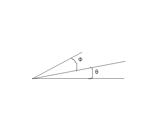

You fire a ball with an initial speed ##v_0## at an angle Φ above the surface of an incline, which is itself inclined at an angle θ above the horizontal (see the above image). (a) Find the distance measured along the incline, from the launch point to the point when the ball strikes the incline. (b) What angle Φ gives the maximum range, measured along the incline? Ignore air resistance.
Identify and set up:
  1. Since there’s no air resistance, this is a problem in projectile motion. The goal is to find the point where the ball’s parabolic trajectory intersects the incline.
  2. Choose the x- and y-axes and the position of the origin. When in doubt, use the suggestions given in Problem-Solving Strategy 3.1 in Section 3.3
  3. In the projectile equations from Section 3.3, the launch angle α0 is measured from horizontal. What is this angle in terms of θ and Φ? What are the initial x- and y-components of the ball’s initial velocity?
  4. You’ll need to write and equation that relates x and y for points along the incline. What is this equation? (This takes just geometry and trigonometry, not physics.)

What I would think you are suppose to do is resolve the gravitational acceleration, g, into its x- and y-components
along the incline, gx, and perpendicular to the incline, gy. The motion of the projectile is
then represented by accelerated motion along both x and y directions with the components of gravitational acceleration.
You problem then reduces to finding the launch angle that gives the maximum x-coordinate along the incline (y = 0).
