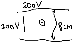

1. Problem - Notes Jumbled, do not know if I am missing variables or not needed to answer the questions?
Disclaimer: I am good at maths, fine with algebra and derivations, I just forget the formulae and units, especially when I haven't practiced things a lot, such as this topic (other subjects getting in the way...)
Diagram:
http://imgur.com/mDBqZN5
The variables I am given are d = 8cm cm, and V = 200 V, m = 2.86E-16. I have access to the mass and charge of an electron/ proton.

1. Gravitational strength? How is Gravity taking place here?
2. F = Eq but E = V / d
F = qV / d
= 1.6E-31 * 200 / 0.08
F = 4E-28 N
But I don't get the diagram, is that halfway, so it's 0.04? I know it's my diagram, but I thought this would be a common question.
3. E = V / d [?]
E = 200 / 0.08 [or is it 400 or 0.04 or both?]
E = 2500 N.C^-1 [Is this an overly high value?]
4. What object?.. I have a feeling this is my rubbish note-taking's fault. Maybe it wasn't an electron, in fact, I just realized the mass is about 10^15 times higher than an electron... I'm lost.
I think you will discover there is a detail in the question specifications that you have overlooked. If I'm correct, it will answer your puzzlement on this point.
I have the feeling that you have not put a conscientious effort into solving this yourself before posting to the forums to seek assistance. I suggest that you make a better effort, then return here and highlight just one or two points on whch you would like help. Most times you will see your way clear to then solving most of the questions after getting a little assistance at one impasse.
Also, you should post the original question verbatim so we get all pertinent information. You have omitted too much.

Alright, sorry. I did not have the original question, and I was looking to see what that may've been. Would you know of any similar questions I could practice?
