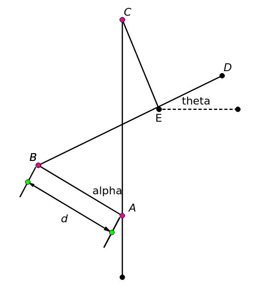

Summary:: We have a rotating arm, offset from the centre of rotation by a certain length, which is controlled by varying the length of a control rod. Need the angle of the rotating arm in terms of length of the rod.
The blue line is a fixed column structure. CE and BD form the rotational arm, and AB is the control rod. The control rod and arm are free to rotate at the points shown (either end of the control rod, the join of the arm and the vertical column (AC)).
My question is, can anyone tell me the function that describes theta in terms of d (theta = f(d))? All lengths other than d are fixed and known. theta is the angle the rotational arm makes with the horizontal.
The pink joints show freedom of rotation.
Angle CED is fixed at 90 degrees.
Lengths LBE, LDE, LCE, LCA are also fixed.
When theta is 0, d = d0.
d = LAB and is variable.

We still need the list of names. Name the relevant points, too. Preferably with a drawing.
(note: the ##\Theta## in your picture are confusing. I suppose they mean"this is a pivot point"
Edited the original post, must've been trying to do so as it was moved between forums earlier.

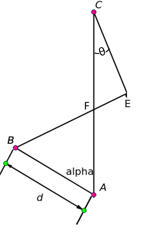

Good. So A is a fixed pivot point. ##\angle## ACE = ##\theta##. So we can concentrate on ABEC with length ##d## as variable.
Working backwards from ##\theta## to ##d## is probably the easiest. Write down some equations: for triangle BAF you have three angles and two sides. Should be easy !
What lines are blue or green?
Apologies they were in the first picture, will change the description.
From triangle CFE:
LEF = LCEtan(θ)
LCF = LCE / cos(θ)
considering lengths:
LBE = LBF + LEF
so:
LBF = LBE - LEF
LBF = LBE - LCEtan(θ)
also:
LAC = LAF + LCF
LAF = LAC - LCE / cos(θ)
Now if we say: β = ∠AFB, using the law of cosines gives:
d2 = LBF2 + LAF2 - 2LBFLAFcos(β)
Which is nearly there apart from knowing β, but I think β + θ = 90o, which would solve this. Is this the case? Or is there something I'm missing on the angles in triangle ABF?

Picture suggests BD ##\perp## CE
BvU said:
For you to know:
Yes that's right, which should mean that the cosine rule based answer is correct? Out of interest is there a more elegant solution I may have missed?
Wouldn't know. With such mixed equations the result may be intrinsically tedious and complicated. To an extent that I personally would leave it to an equation solving algorithm. But perhaps someone else can enlighten us ?
Since BC is a fixed distance, I would start by finding the angle BC makes to the vertical as a function of d.
