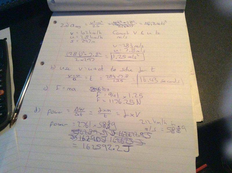

This is my attempt:
Show us your best effort so far.

This is my attempt:
I could follow your working down to the point where you calculated time. All that looks ok.
You then calculated a force, but have not stated what that force is, so I cannot say if you have that right. How are you defining F there?
At this point I would like to grasp the problem setter by the collar and scream into his/her face FRICTION IS WHAT MAKES THE CAR ACCELERATE. Without friction the wheels would just spin. Presumably the problem setter meant air resistance plus rolling resistance equals 1160N.
Yes it was part c and D that got me really confused any advice on how to answer that? I just guessed and plugged in the mass 941 and the acceleration 1.25 into f=ma to get that number.
You still have not defined that f. How is f defined in f=ma?
I think i am defining it as the amount of force required to make the car accelerate at the value 1.25m/s^2. But is that tractive force then?
In the equation F=ma, F is the net force. What forces act to produce this net force?
The resistant force 1160 so it would be 941 * 1.25 and then that subtract that resistant force to get the actual driving force?
Write an equation relating Fnet, Fresist, Fdriving. You can either take the same direction as positive for each, so some may turn out negative in value, or take each of those values to be positive and so define different directions for them. Your choice, but say which you choose and be consistent.
aah so if Fnet is Fresist + Fdriving then Fdriving is mass * acceleration - (-Fresist) since Fresist is in the opposite direction
Yes.

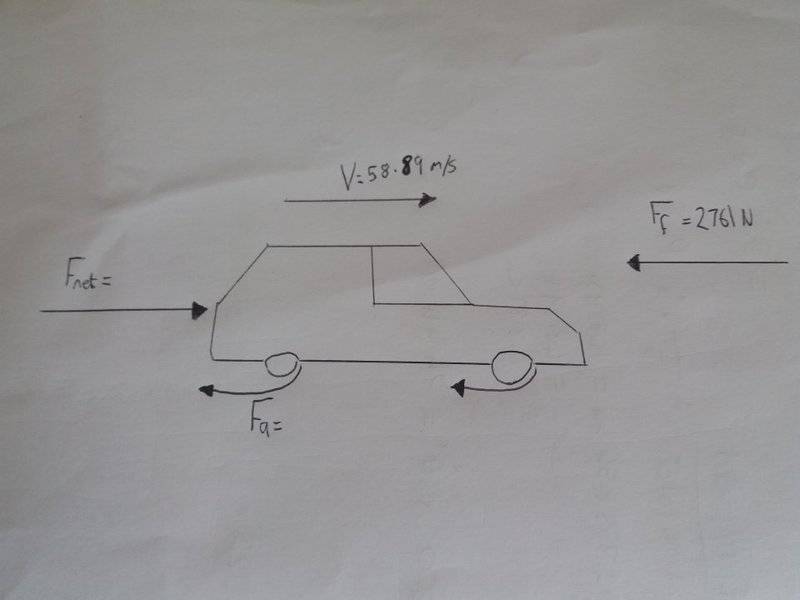

This is the formula I have for working out tractive force where Force applied(Fa) is the tractive force:
Fa = Fn + Ff
Fa = 0 + 2761
Fa = 2761N
WherE mE weeD said:
I would think the wind and air resistance (Ff2) would be opposing forward motion?
Wind and air resistance are the same thing. The other force opposing motion is rolling resistance. This consists of several components: axle friction, road surface flexion and tyre flexion.
Fa = Fn + Ff
Your diagram is wrong. The tractive force acts in the forward direction (or the car would not go forward).
Your choice of subscripts for the forces is not helpful. "a" suggests acceleration, "n" suggests normal and "f" suggests friction.
I'll use t for traction, r for resistance and net for net.
By definition, the net force is the sum of all the applied forces. That is a vectorial statement, but applies to scalars too as long as we are careful with the signs; i.e., choose a positive direction for all forces and the acceleration.
Fnet=Ft+Fr.
In your diagram, if we choose left to right as positive then Ft is positive and Fr is negative.
Since there is no acceleration, Fnet=0.
See also section 4 of https://www.physicsforums.com/insights/frequently-made-errors-mechanics-friction/
Likes WherE mE weeD
Fnet=Ft+Fr.
That clears up the subscripts big time cheers. If Fnet = 0N and Fr = -2761N due to the direction (right to left) then Ft = +2761N.
So the formula for power is E out/time taken or P=FV
So we use the Traction force to work out power as it is the means to the car moving?
P=2761x58.89=162595.29J = 162.6KJ = 162.6KW
Yes, but try to handle the units consistently.
P = 2761N x 58.89m/s = 162595 Nm/s = 162595W = 162.6kW.
Not J, KJ, or KW.
Likes WherE mE weeD
Not J, KJ, or KW.
I think I am getting mixed up with energy and I have no excuse for the KW lol. Cheers
