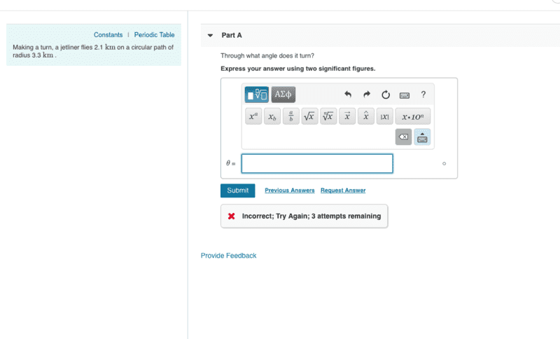

Making a turn, a jetliner flies 2.1 km on a circular path of radius 3.3 km.
Through what angle does it turn? Express in 2 significant figures.

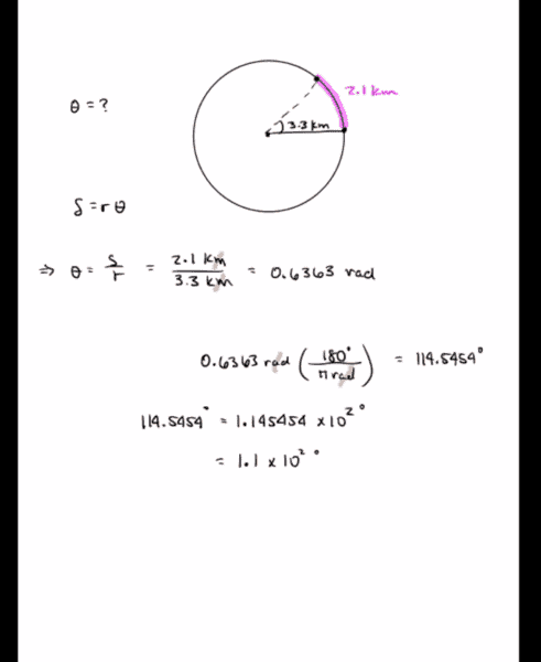

Arc length = ##S=rθ##
Please see the attached image. I've tried multiple different forms of the answer and none of them are being accepted. Is it conceptual?

A screenshot of the problem.

Looks like you overlooked the factor of π in the denominator when converting to degrees.
Oh man. Been a long day. Conceptually, you'd call it good?
Yes. The problem statement doesn't indicate the units required for the answer. So, maybe you don't need to convert to degrees.
Likes opus
Thanks. I really need to try to slow down on working problems. Once I miss something and look it over for errors, it's like the error blends in and I don't even notice it.
I don't like the degree thing as it makes more sense to be in rad, but by the looks of the screenshot of the problem, it looks like it's got a degree symbol to the right.
opus said:
... but by the looks of the screenshot of the problem, it looks like it's got a degree symbol to the right.
Ah, I hadn't noticed. Thanks.
