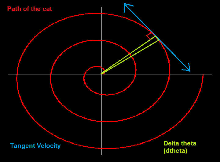

What does U equal? Give me a magnitude in terms of r, r dot, and theta dot.
Thanks for the reply. Here's my train of thought. Essentially the lion is moving in a sort of circular motion with the radius increasing wrt time. So r=r(t). Now, U=ds/dt, where s is the distance covered by the lion. This is given by, I think, rθ. So ds/dt = (dr/dt)*θ + r*(dθ/dt) = U.
Am I on the right lines, because I have a funny feeling I'm not..
Almost. Think pythagorean's theorem.
Theta dot is always perpendicular to r dot, so you have a right triangle between the 2.
Check the first term again (dr/dt)*\theta
Does the magnitude change depending on which angle your facing? If you rotate the spiral, changing the starting position of Joe (? whatever his name is), does that change the magnitude of the the lions velocity?

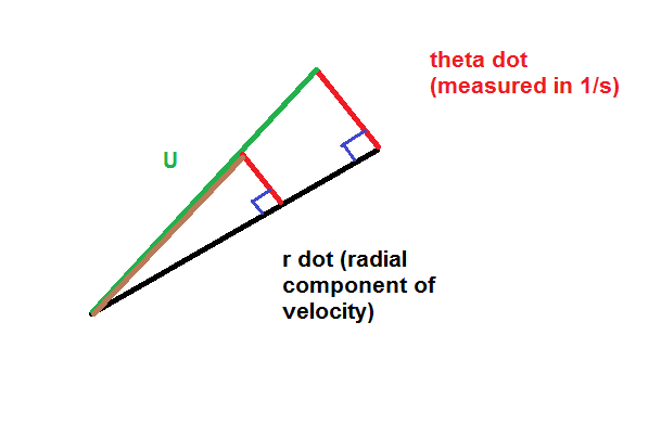

maybe that picture had too much going on. Try this one. Can you tell me what U is equal to now?
Aha! U = sqrt(rdot^2+theta dot^2)?
Super close now. Check out the units. Rdot is m/s and theta dot is 1/s, what happens the the arc of a circle if you go farther away from the center?
If I travel from 0 to pi along the circumference of a circle with radius 1, then do the same thing with a radius 2, how will my total distance traveled compare?
Does the brown line or the green line have a greater magnitude? How can you relate that to what we have to work with? The angle changed in both cases will be the same, but which velocity is greater? How can you take your equation and change it (only 1 small change that needs to be made) so that it accounts for this?
Would it be multiplying theta dot with r^2? That way the units correspond to each other on the LHS and the RHS. Also, it's the change in radius that yields the greater velocity of the green line. Would that be right?
yea yea. cool. I'm assuming we're on the same page now, with ##U^2 = \dot{r}^2 + r^2\dot{\theta}^2##
