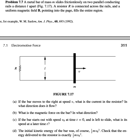

Motional EMF -- problem 7.7 in Griffith
In summary, the student is seeking help with solving problems (c) and (d) in regards to a bar experiencing magnetic force. They determine that the speed of the bar will remain constant due to the nature of magnetic force. However, they are struggling to understand the concept of energy dissipation in regards to resistor and question (d) does not make sense to them. They are asked to compute the energy dissipated in the resistor using the formula ∫i2R dt.
Pushoam
962
52
I need help in solving (c) and (d).
Since the force acting on the bar is Magnetic force and magnetic force does no work, the speed of the bar will remain same i.e. v0.
Question (d) is not making sense to me.
Energy is being dissipated in the resistor. Where is this energy coming from?
Likes Pushoam
Compute the energy dissipated in the resistor as ∫i2R dt.
