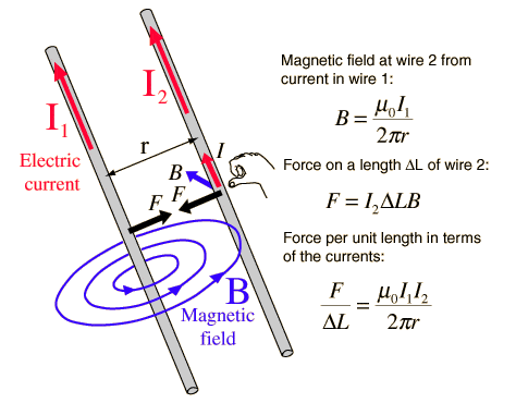

My question is basically about the force experienced by a current carrying conductor placed in magnetic field.
You must read the post #2 again. The wires are often "hidden" in grooves, and thus is not exposed to a magnetic field of significance: The motor will yield a torque anyway.
If the wires are hidden in the slots, what causes back emf?
Forget about motor..If a wire is held in between two poles and current is passed through it, it will have its own magnetic field which will be in circles around the wire. This will distort the original flux(N to S) in such a way that it will increase above the conductor and decrease below the conductor (assuming proper polarity and current direction). Won't this lead to a reasultant force upside down? If no such interaction happens, where's the force coming from?? Also, is its msgnitude BILsinθ??
In Quantum Physics, electric forces are sometimes modeled as virtual photons. But following that answer leads down a rabbit hole. (What is "virtual"? How do photons interact on a quantum level? Etc.) If you wish to know more, get a good textbook on Quantum Electrodynamics.
Otherwise just accept that fields exist and the EM fields follow Maxwell's equations.

Thanks jim..That helped a lot.. Especially that cross product mechanism which takes place twice..:smile:

Magnetic fields don't interact ? Sounds cunterintuitive at first but think about it...
If i hold two magnets close to one another, the force i feel is exerted on the magnets .
Probably semantics - our mind tends to leap past the necessary baby steps of thinking .
Likewise in the motor the force is exerted on the wire, even if only because the charges are constrained to stay in it. .
This hyperphysics link is a bit more academic than my explanation, it introduces the idea of magnetic moment .

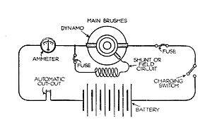

Realize that a motor and a generator are identical, the only difference being direction of power flow.
They added a third brush to generators in early automobiles to power the field. Armature reaction distorted the flux hence the current to the field which made them self regulating. Model A Ford(1932) is the last one of those I've personally encountered.
https://en.wikipedia.org/wiki/Third-brush_dynamo
Should you encounter one here's a practical page to know about
http://www.yesterdaystractors.com/articles/artint4.htm
of course the same applies to motor operation of the three brush machine.
Ford windshield wiper motors as late as the 90's had three brushes for better speed control.

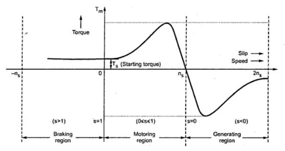

This curve shows that torque reverses when rotor field overtakes stator field and it becomes a generator.
ns is line frequency rpm - for 60 hz 1800 or 3600 or 1200 or 720 or whatever.
http://www.expertsmind.com/topic/induction-motors/torque-slip-characteristics-917822.aspx
531_Torque-Slip%20Characteristics3.jpe
Figure: Torque-Slip Characteristics
The torque is zero While slip is zero; (Nr = Ns). We have already discussed that induction motor torque is zero at synchronous speed. At slip Sm, T; the motor gives the maximum torque that is also called as break down torque. While the rotor is stand still (S = 1), the torque corresponds to beginning torque Ts. In normally designed motor Ts is much less than Tmax (Break down torque). The torque slip characteristics from no-load to rather beyond full-load are almost linear.

Just one last question..If I placed another wire very close to the original wire in the diagram and sent current through it in the opposite direction, the resultant magnetic field due to both the currents will be almost 0. Will there be a force on the wire?? There won't be any distortion of flux as seen in the original diagram. Will Lorentz force act on them??
  • #33
Not trying to duck your question here...
I assume your two wires are physically kept close together by something like glue , or their innate rigidity ? If not the geometry will change and the problem becomes dynamic.
I'll answer that each wire will experience a vertical force from its Lorentz force effect and those forces of course sum to zero. (ignore the torque couple for now)
and there's an additional force on each wire from the other one
http://hyperphysics.phy-astr.gsu.edu/hbase/magnetic/wirfor.html
of course you postulated current in opposite directions not same direction as in this figure - so wouldn't that force be repel not attract ?
I've been thinking nights about your questions
and they make me ponder what is nature of space that force is transmitted between objects over a distance by magnetic and electric and gravity fields?
Higher math is able to describe the interactions out there in free space not just at the objects.
But we can only sense the resulting force at an object like a wire or a charged piece of matter where we can attach a force measuring device..
I need an aether.
I think that's why i stick with my 19th century analogies - my algebra is so prone to mistakes that i have to visualize the forces before i'll believe the math.
