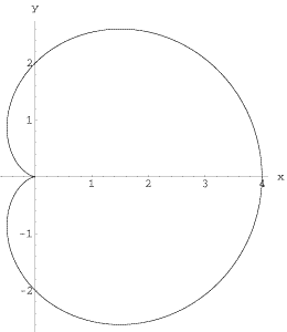

A particle moves with velocity ##v## along the cardioid ##r=k(1+cos\theta)##. Find ##\vec{r''}\cdot \hat{r}## and interpret the result. At what angles will this coincide with the centripetal acceleration?
To find ##\vec{r''}\cdot \hat{r}## I will simply use the formula for the radial acceleration in cylindrical coordinates. This is ##\rho''-\rho\theta'^2## which after lengthy manipulation gives: ##-k(\theta'' sin\theta + \theta'^2cos\theta)-k\theta'^2(1+cos\theta)##. Which I have no idea how to "interpret", haha.
To solve the second part well I know the position vector is ##\vec{r}=r\hat{\rho}## and that its derivative with respect to ##\theta## will give a tangent vector to the curve. This is simply ##\frac{d\vec{r}}{d\theta}=\frac{dr}{d\theta}\hat{\rho}+r\hat{\theta}##
The unit tangent vector is simply: ##\hat{t}=\frac{1}{\sqrt{(\frac{dr}{d\theta})^2+r^2}}(\frac{dr}{d\theta}\hat{\rho}+r\hat{\theta})##. Which helps me to find the orthogonal normal vector and thus the centripetal acceleration as ##\frac{v^2}{R}\frac{1}{\sqrt{(\frac{dr}{d\theta})^2+r^2}}(\frac{dr}{d\theta}\hat{\theta}-r\hat{\rho})##. Note I've switched components on the and sign on one component as well.
This helps me notice that the centripetal acceleration coincides with my above result when the centripetal acceleration is purely in direction of ##\rho##. This happens when ##\frac{dr}{d\theta}=k(-\sin\theta)=0## which is for Pi and 0.
Now, help me interpret the acceleration expression I derived above to which I'm expected to provide an interpretation. Also, is my procedure correct?
Thanks for reading this tedious thing.

David,
To understand even better what is happening here, plot the graph. It will then make sense visually to you.
Chet
The thing about my result being equal to the centripetal acceleration and ##0,\pi## makes sense to me, however what doesn't make sense to me is that the radial acceleration should be a constant of this motion. I've already graphed it. Any ideas?
Well, from the graph, you can probably see by eye that the radii of curvature are the same at 0 and pi.
Chet
But how does that prove that the radial acceleration should be a constant of this motion? I think that would only prove the centripetal acceleration is equal at 0 and pi. Plus, I think the radius of curvature at the kink (probably theta=pi in your graph) is ill-defined.
I haven't plotted it myself yet, so I was just guessing.
its basically just this
I doesn't look like you are going to get a satisfactory understanding of what you want from the figure. If it were me, and I were motivated to resolve this issue (which I'm not), I would calculate the radial and circumferential components of the acceleration at a selection of angles from 0 to 360, and plot these on the figure. That way I could see by eyeball how it was playing out. If that still didn't satisfy me, I would also make another similar plot, but this time with the normal and tangential components of acceleration. Hopefully that would all do the trick.
Chet
Likes davidbenari
I'll check it out. Thanks for everything though.
