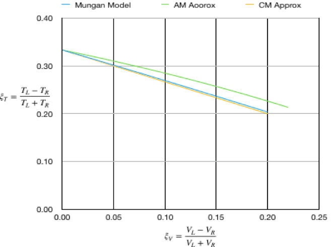

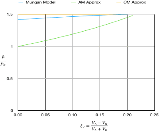

I'm not arguing that if the partition is released and the system is allowed to re- equilibrate, the change in internal energy will be zero. What I am saying is that this process will not be even close to reversible, to the extent that the equations for a reversible process can not be used. And I am also arguing that, if the pins-and-notches version that you suggested will also not be even close to reversible.
Chestermiller said:
I'm not arguing that if the partition is released and the system is allowed tore- equilibrate, the change in internal energy will be zero. What I am saying is that this process will not be even close to reversible, to the extent that the equations for a reversible process can not be used. And I am also arguing that, if the pins-and-notches version that you suggested will also not be even close to reversible.
