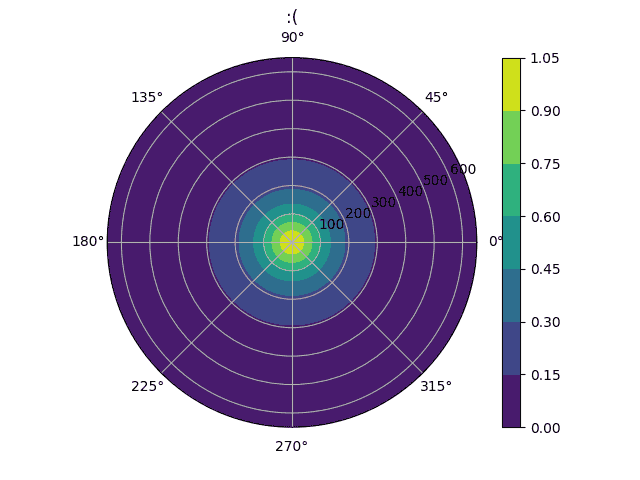

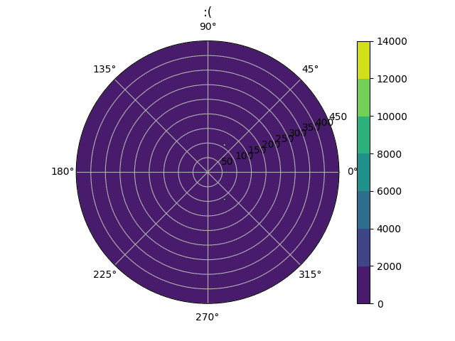

I have a function in polar coordinates:
t (rho, phi) = H^2 / (H^2 + rho^2) (1)
I have moved the center to the right and want to get the new formulae.
I use cartesian coordinates to simplify the transformation (L = 232.5).
rho^2 = (x')^2+(y')^2
x' = x-L (2)
y' = y
Then I substitute expression (2) into (1) and go back to the polar coordinates (using x=rho*cos(phi) and y=rho*sin(phi) ). The result is:
t (rho, phi) = H^2 / (H^2 + rho^2 - 2 * rho * L * cos(phi) )**2 (3)
The first picture is for (1) function.
The second picture is for (3).

It looks to me like you are omitting the ##L^2## term in the denominator. After the substitution -- in equation (2) -- I get this:
$$t(\rho, \phi) = \frac{H^2}{H^2 + (x - L)^2 + y^2} = \frac{H^2}{H^2 + x^2 - 2Lx + L^2 + y^2} $$
$$ = \frac{H^2}{H^2 +\rho^2 - 2L\rho\cos(\phi) + L^2}$$

Does my change make a difference?
Yes. I made such a stupid mistake. Thanks for advise about LaTeX
