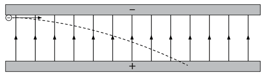

An electron is fired at 4.0 × 10^6 m/s horizontally between the parallel plates, as shown, starting at the negative plate. The electron deflects downwards and strikes the bottom plate. The magnitude of the electric field between the plates is 4.0 × 10^2 N/C. The separation of the plates is 2.0 cm.
a) Find the acceleration of the electron between the plates.
b) Find the horizontal distance traveled by the electron when it hits the plate.
c) Find the velocity of the electron as it strikes the plate.
1) m * a = ε * q
2) ∆d = v * ∆t + ½ * a * ∆t^2
3) v[SUB]2[/SUB][SUP]2[/SUP] = v[SUB]1[/SUB][SUP]2[/SUP] + 2 * a * ∆d
245982
a) We can solve for acceleration by looking at FNETy
FNETy = FE (G is negligible)
FNETy = m * a
The mass (m) of an electron is 9.1093836 x 10-31 kg.
The elementary charge (q) of an electron is -1.60217662 x 10-19 C
a = ε * q / m
a = (4.0 x 102 N/C * 1.6022 x 10-19 C) / 9.1094 x 10-31 kg
a = 7.0353 x 1013 m/s2
Our electron is fired south and hits the positive plate.
Therefore, the acceleration of our electron is 7.03 x 1013 m/s2.

Your work looks very good (but I did not get out my calculator to check the arithmetic).
However, part (C) asks you to find the velocity of the electron as it strikes the positive plate. You found the vertical component of the velocity. Is there also a horizontal component?
Likes Jkalirai

Huh, you know... I actually sat down for like 20-30 minutes and really wondered why I didn't even consider a horizontal portion. I worked through the problem again, I knew that horizontal acceleration was 0, meaning that the initial velocity is the same as the final velocity. After that, it's just a matter of putting the pieces together where v2 = √ (vx2 + vy2). Well anyways... after working through it I got a similar answer to what every other thread seems to be saying. Seems like a silly mistake to make but thanks for the heads up.
