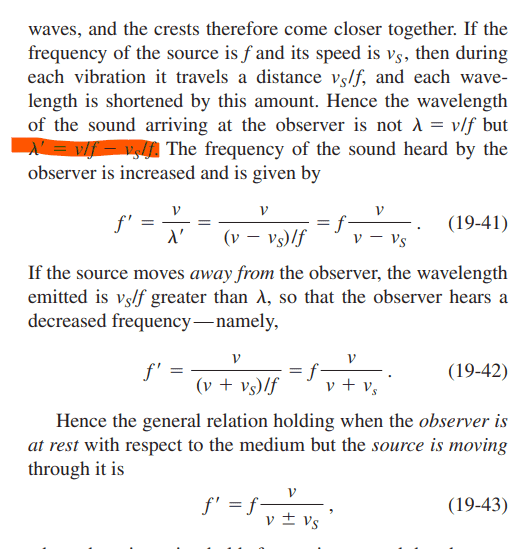

Does someone please know whether they assume for the equation highlighted that ##\frac{v}{f} ≥ \frac{v_S}{f}## since otherwise the wavelength would be negative (which I assume is impossible)?
Many thanks!

The object would be moving faster than the sound speed; i.e., supersonic which is a different physical regime.

Thank you for your reply @Frabjous!
