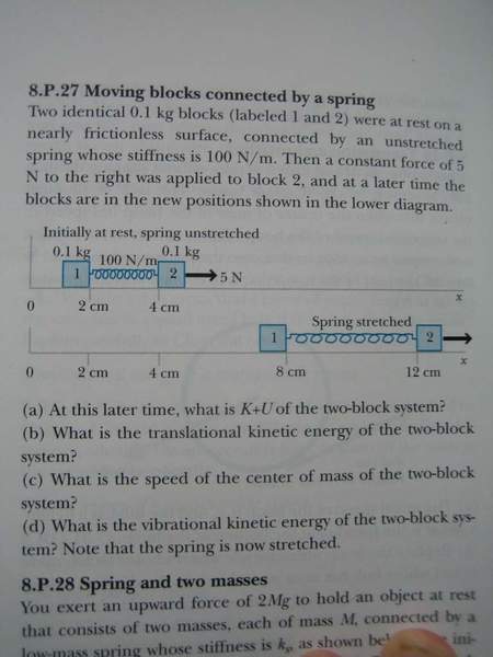

soupastupid
34
m_1, v_1f
m_2, v_2f
m_2 = m_1 = m
KE = .5mv^2
W = F*d
spring: F= -kx
pot energy = PE = -.5kx^2
A) K + U = .5m(v_1f)^2 + .5m(v_2f)^2 - .5kx^2
.5(.1kg)(v_1f)^2 + .5(.1kg)(v_2f)^2 -.5(100N/m)(.02m)^2
B) ??
translational KE - going straight?
isnt it
C) ??
V_cm...
am i looking for how fast the center of the spring is moving?
the center of the spring moved from .03 m to .1m
and so
?? I am lost
or do I get the average speed of the two boxes which would be
V_cm = (V_1f+V_2f)/2
or
.5(.1kg)(v_1f)^2 + .5(.1kg)(v_2f)^2 -.5(100N/m)(.02m)^2 = Wd = (5N)(.08m)
(v_1f)^2 + (v_2f)^2 = 8.4 (m^2)/(s^2)
does that equal V_cm?
V_cm = ( 8.4 (m^2)/(s^2) ) ^ (1/2) = 2.90 m/s
D) ??
vibrational?

(A)
How much work has been done on this system?
Wd = (5N)(.08m)
Okay, so the energy system has increased by that amount. That helps with (A), getting the total energy K+U. Do you see why?
what are you trying to say?
the initial energy = 0
becuz the objects are at rest and spring is at its natural lenght
so therefore
the final energy is K + U which is equal to Wd
that?
and so
.5m(v_1f)^2+.5m(v_2f)^2-.5kx^2 = (100N/m)(.08m)
KE m1 KE m2 PEspr Wd
so my answer is??
8 Joules

Yes, correct.
so therefore
that?
Almost. K+U is equal to the work done, W=Fd:
Wd = (5N)(.08m)
Well, this is really W or Fd, but not Wd. At any rate, multiplying (5N) times (0.08m) will give you the answer to (A).
and so
so my answer is??
8 Joules
No, see above comments.
