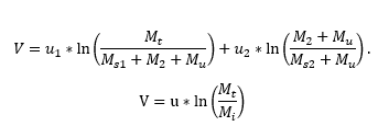

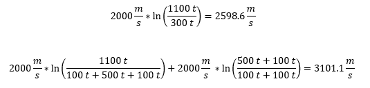

I have to show why there advantageously can be employed multi-stage rockets
How do i do this best, a graph/plot?
i have done some calculations for a single stage rocket and a multistage rocket, but how can i show this more over all?
It is very difficult to follow your equations. If you would like to make a more general statement use variables rather than numbers. Also define what those variables mean.

Hello i have the equation with variables:
Should i explain this mathematicaly, and if so can you give a little hint? :)

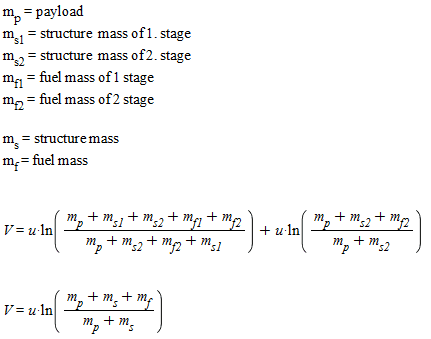

Now you need to relate the two situations. What if the single stage and the two stage have the same total mass. Also say they have the same payload mass and fuel mass. The part that is missing is the mass of the structure. Say they have the same structure mass, but with the two stage rocket you get to throw away a large fraction of that for the second stage. Can you show the final v is greater in the two stage?
Ps. In your first stage you do not burn all the fuel, so some of the fuel mass should appear in the denominator in the log.

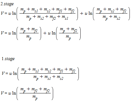

i have done it with structure mass and so, I am not sure on how to relate the two situations, if they have the same payloat its mp =mp and same fuel mass; mf=mf1+mf2 - and the same structure mass then its ms=ms1+ms2?
and why is there fuel left in the first stage?
The fuel left after the first stage is the fuel carried in the second stage. The second stage has to have fuel!
To relate them write the single stage eqn using the same terms assuming things are equal because you want to compare similar rockets.
Same amount of structure: not ms, but ms1 + ms2,
Same amount of fuel, so not mf, but mf1+mf2
Now with both equations in the same terms can you prove algebraicly that the two stage velocity is greater than the single stage?

but I am a bit unsure, because, in the 2. stage rocket the u, could be different in each stage, so
i have taken the part that goes out with each other, and i can see it must be larger.

What you wrote in the first line in each kind of rocket is correct. I think the math leading to the second line in each case is flawed. That's ok. You only need the first line of each. Now put them on a line together with ">?" between them and do algebra until you prove it's true. You should be able to prove it's true as long as ms1 > 0. (And to be sure I'm not asking the impossible I did work it out myself)
