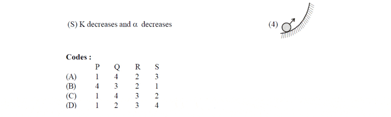

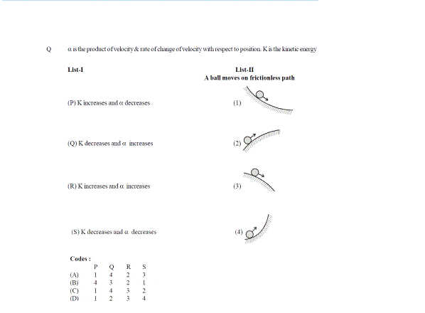

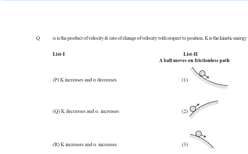

## α = v\frac{dv}{ds} ## and K is the kinetic energy .
In all the four cases ## α = v\frac{dv}{ds} = mgsinθ ## where θ is the angle which the normal to the body makes with the vertical .
Fig 1) K increases and tangential acceleration α decreases ,so matches with P)
Fig 2) K decreases and tangential acceleration α also decreases ,so matches with S)
Fig 3) K increases and tangential acceleration α also increases ,so matches with R)
Fig 4) K decreases and tangential acceleration α increases ,so matches with Q)
According to me the correct option is (C)
Is this the correct option ?
Many thanks

I think you accidentally added an [itex] m [/itex] in there that doesn't belong.

Yes, your choice looks correct to me. :approve:
In case you missed it though, there is another way to express the [itex] \alpha = v \frac{dv}{ds} [/itex]. Can you represent [itex] v [/itex] in terms of [itex] ds [/itex] and [itex] dt [/itex]? if so, replace [itex] v [/itex] with that in your equation and see what happens. It should then be quite clear why the [itex] g \sin \theta [/itex] makes perfect sense. :wink:

[itex] v = \frac{ds} {dt}[/itex] and [itex]α = \frac{dv}{dt}[/itex] which is the tangential acceleration .
Is this what you are suggesting ?
That's it. :smile: It was just to point out that [itex] \alpha [/itex] is the ball's acceleration.
And yes, just to avoid ambiguity, [itex] \alpha [/itex] is the tangential component of acceleration, as you have correctly suggested. :smile: (There's also a normal component, but that's not relevant for this problem.)
